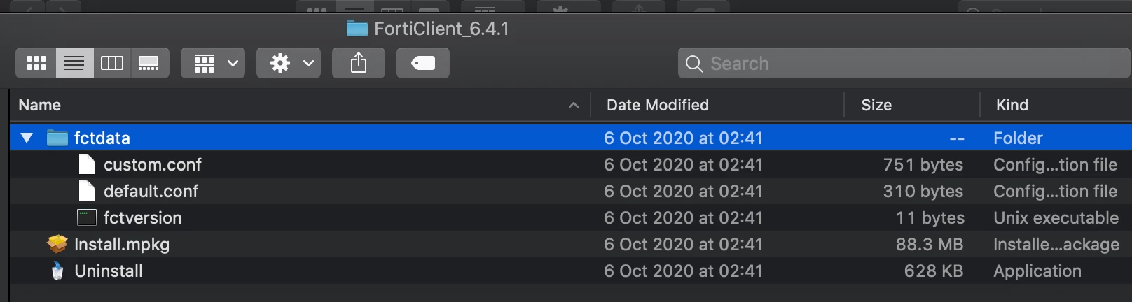

Hi @HelpDeskDog, So basically I created a new folder and copied the (Install.mpkg & fctdata folder "the folder that contains our 2 custom .config files") from the (.dmg) to the new folder called (FortiClient_6.4.1).
Now drag & drop the new folder into the composer app. and add the following script to the post install scripts:
cd /library/Application Support/JAMF/temp/
hdiutil attach -nobrowse FortiClient_6.4.1.dmg
cd /Volumes/FortiClient/install.mpkg
installer -pkg install.mpkg -target /
cd /
sleep 20
hdiutil detach /Volumes/FortiClient
echo "cleaning up"
rm FortiClient_6.4.1.dmg
Once you and the script to the post install, build a (.dmg) file and add it to to your VPN jamf policy.
