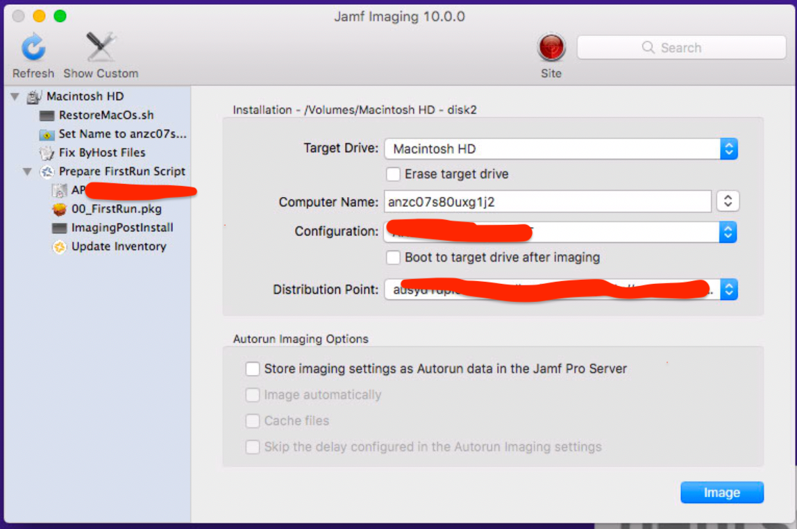

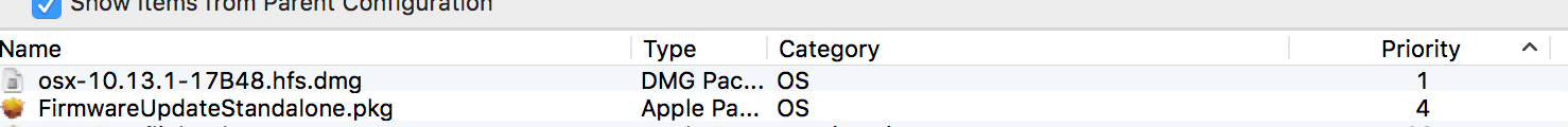

This is for AHFS only I used the package outlined by Graham. https://github.com/grahamgilbert/imagr/wiki/High-Sierra-Notes
Firmware. Lay the image then the firmware pkg and ad my postlight to it..been working good
  • November 3, 2017
@daniel.hayden
Thanks for that. From your screenshot, do you still use the RestoreMacOS.sh and ImagingPostinstall.sh? Mine to share your workflow?

-Where can I get the standalone firmareupdater packages? I can't find them in the 10.13.1 "Install macOS High Sierra.app" installer app (I have the full ~5GB installer, not the ~20MB "stub")

Hi Guys,
Just to clarify a few of the bits of confusion above. My Macs are bound to AD and the first local-admin account (Non casper managment account) is created by a policy on enrollment complete.
I also have a pkg that is installed as part of the imaging workflow. This will cause the machine to reboot which should then trigger the /usr/local/scripts/NextBoot.sh script. This script is run by a launchDaemon that will run when the machine reboots for the second time.
You also don't want to select erase drive as the script needs to read info on the existing install and then uses ASR to wipe the drive.
Here is what my Jamf Imaging looks like
Having any package install on drive after reboot in your config will cause the mac to reboot after enrollment complete and trigger the 10.13 upgrade.
Ash

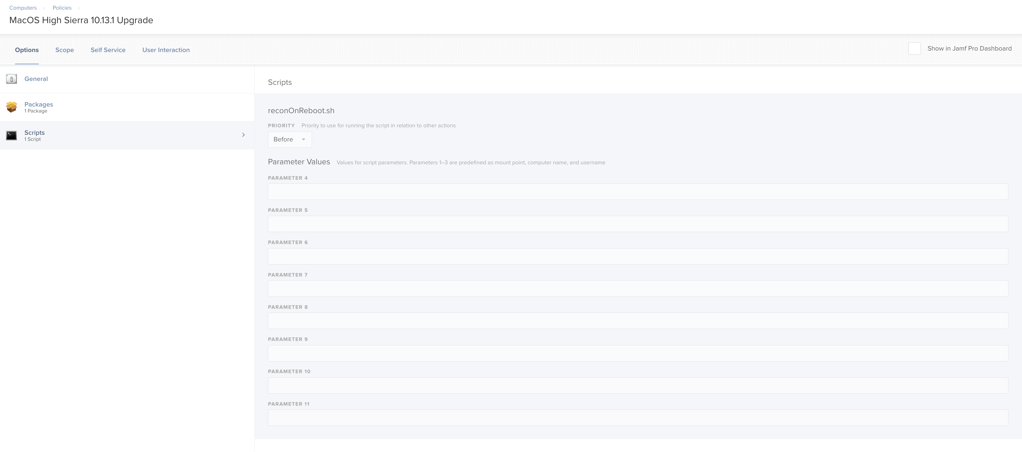

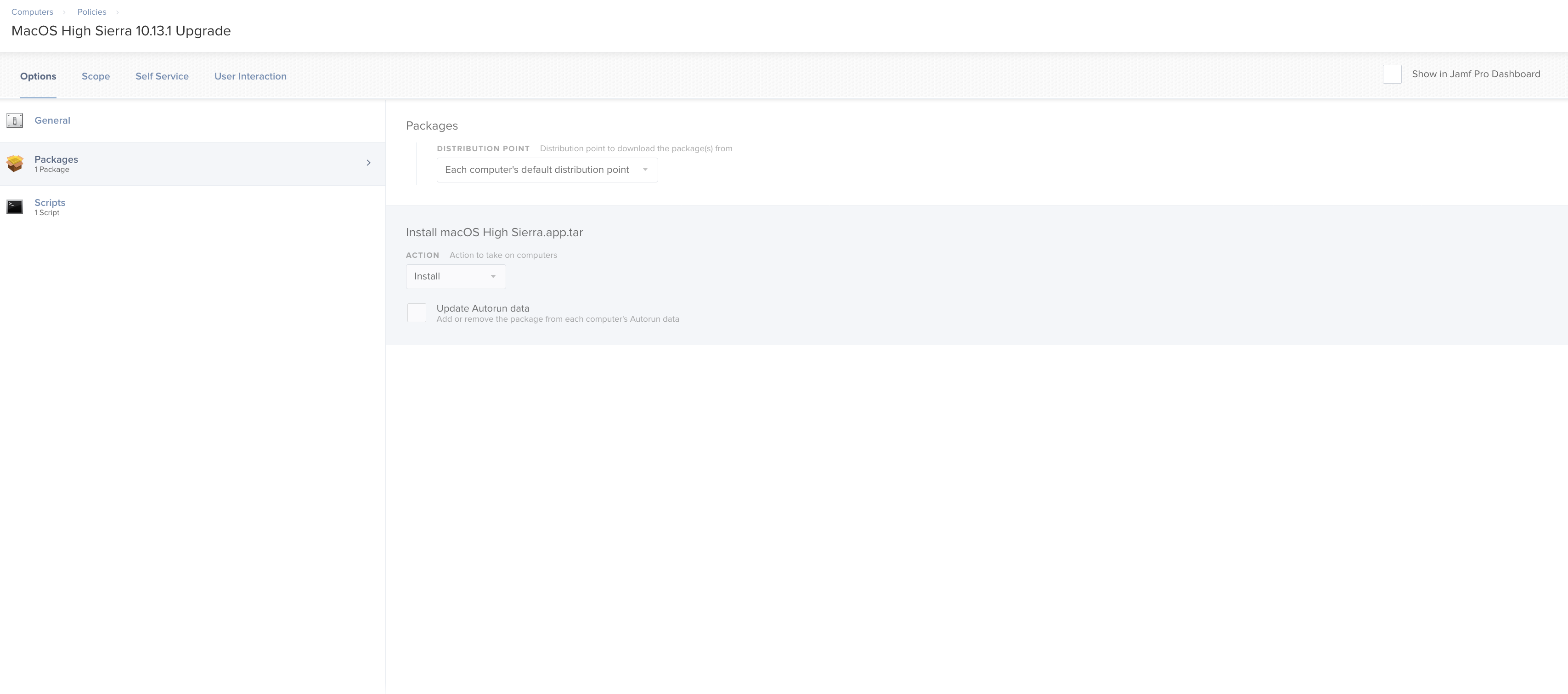

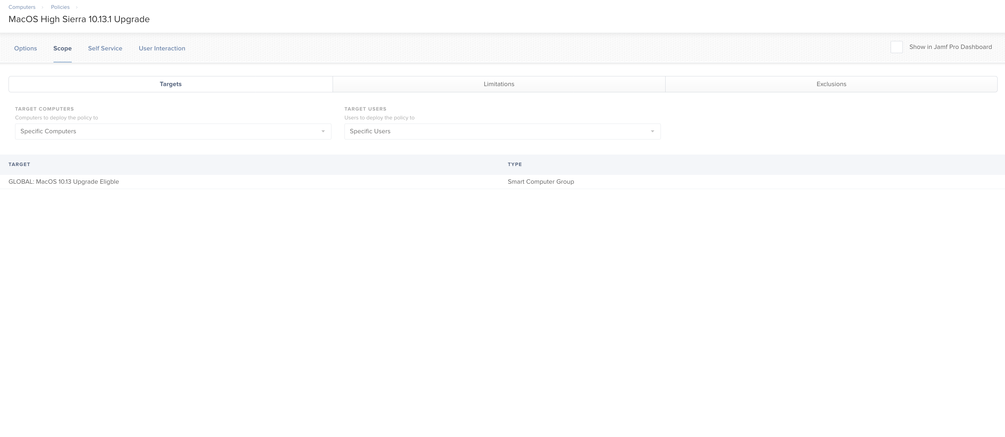

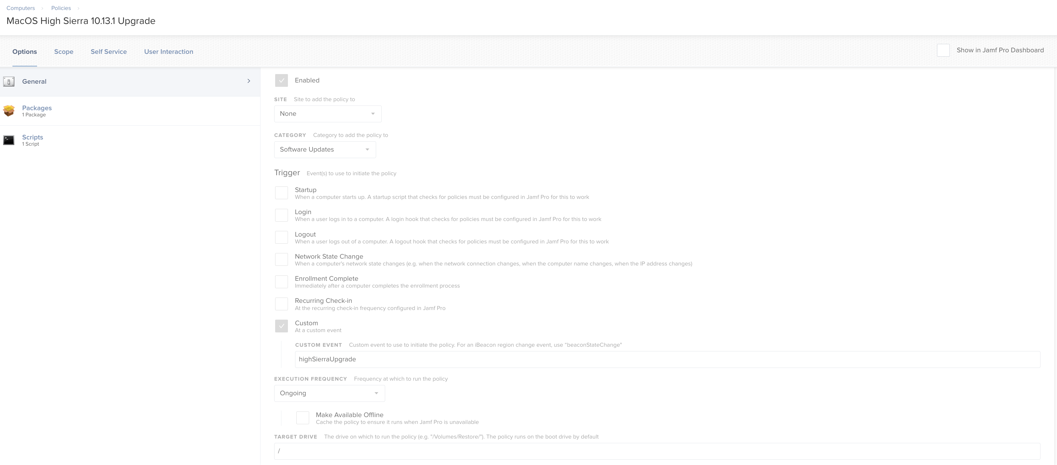

@mwilkerson This is a policy with a custom trigger called highSierraUpgrade
You can find instructions for creating this policy here:
https://www.jamf.com/resources/webinar/managing-ios-11-and-macos-high-sierra-upgrades/
Starts at around 22Minutes.
Basic of it are:
1. Download the High Sierra Installer from the App Store
2. Drag the installer into casper admin.
3. Create a policy that installs that package you just copied to casper admin.
4. Create a custom event trigger called highSierraUpgrade
Here are screen shots of my policy.
Ash :)
