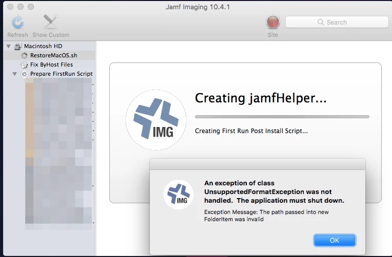

I am encountering the following error during thin provision method given by @reddrop on the first run every time.
After that, the JAMF Imaging app is quit and relaunched to start the process again. On the second run, it went well without any error. The nbi is based 10.13.4 macOS created by Autodmg and I am using JAMF Cloud 10.4.1. This is happening only for High Sierra thin provision config and previous configurations like Sierra Imaging Configuration are running fine without any error.
Anybody having the same issue?
russeller
  • May 31, 2018 1:26 PM UTC
@mchit i just had something similar happen to me. I had to launch Jamf Admin, create a new imaging configuration named slightly different than my current one, drag and drop all the same items from the old config into the new one. Then delete the old config and that fixed it. Basically duplicate the config. Dumb, I know. Hopefully that helps.
