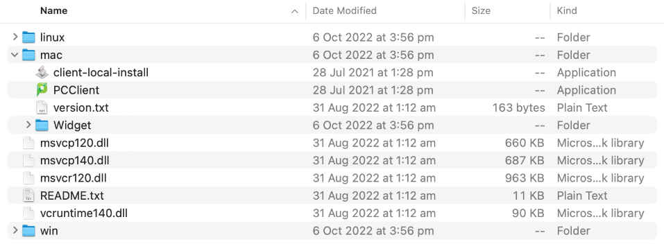

Head to your Papercut server / PCClient share. There's a macos applescript to deploy the print client to end user devices. Should give you a start.
https://www.papercut.com/help/manuals/ng-mf/clienttool/user-client-install-mac/

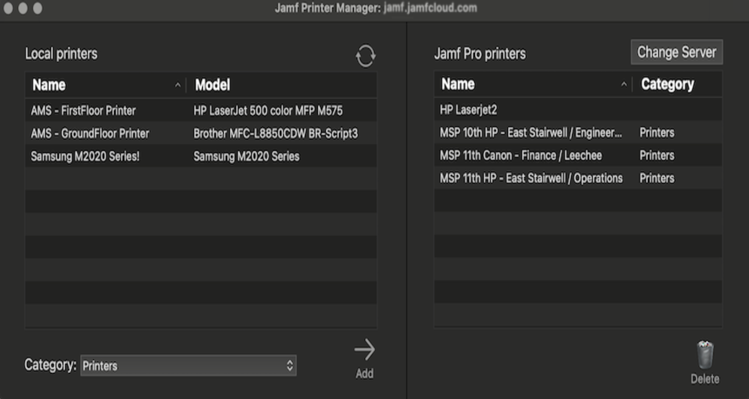

Print queues, try Jamf Print Manager. Install to your local device then export to Jamf for deployment. I haven't tried, i use lpadmin still..
https://trusted.jamf.com/concepts/docs/jamf-printer-manager

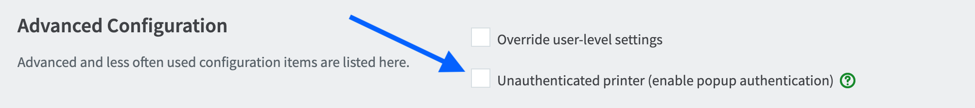

Hi Norman
You can run both the Print Deploy client and PCClient simultaneously. Just keep the following checkbox unchecked in the PaperCut NG/MF admin interface.
If you check this checkbox, PaperCut NG/MF will expect the PCClient to authenticate the print job. But since Print Deploy already takes care of authentication, that won't be needed.
With this setup, the PCClient will only be used for the shared account selection.
