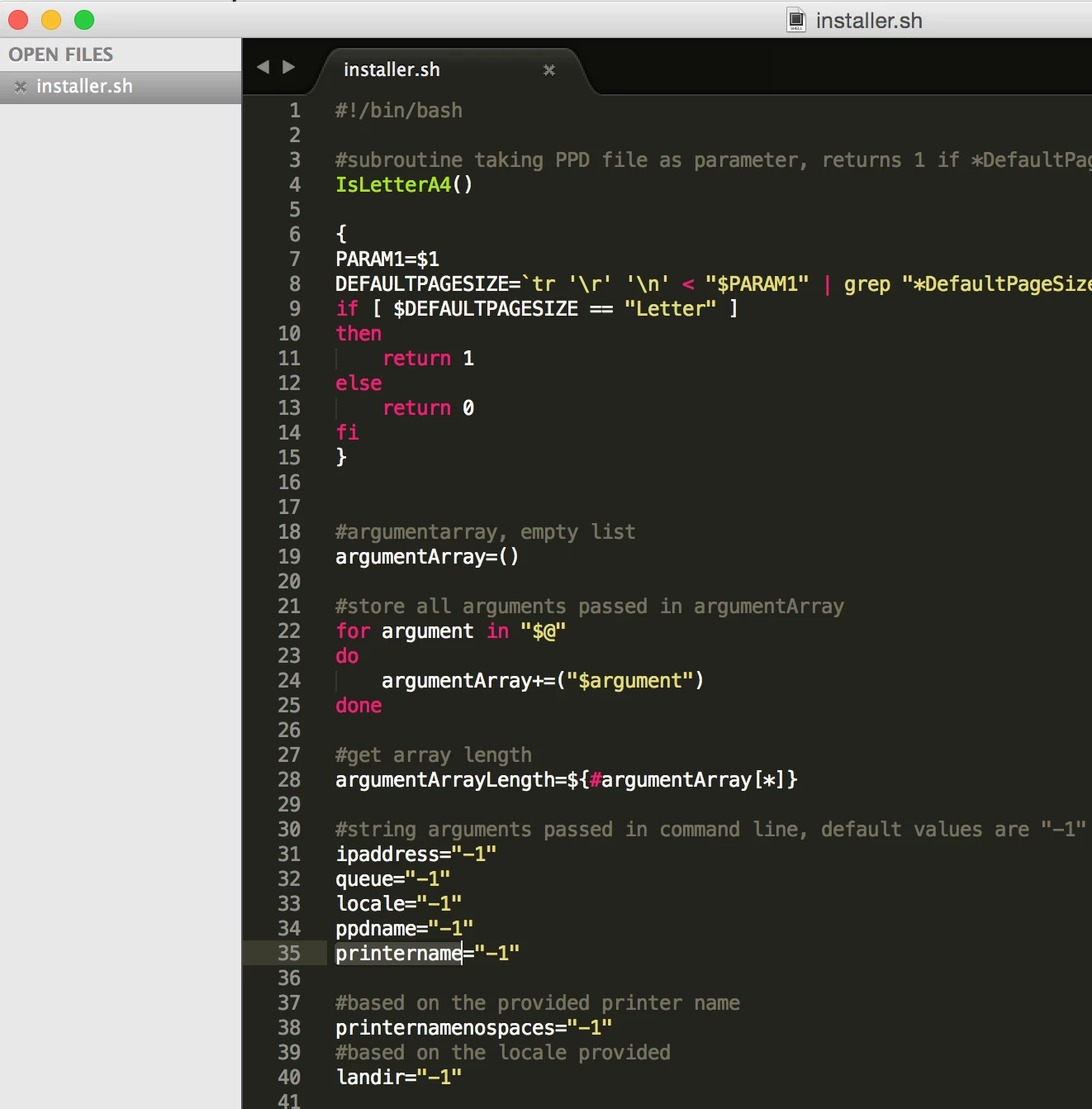

The current crop of Fiery drivers for Xerox (looked at both V80 and C70 entry production level machines) are different, I feel, when its time to auto deploy them.
You see, in the .dmg, there's a .pkg. So many will automatically say "Put that in Casper and you're done". Well, close, but no cigar.
When you do put the pkg in casper, it deploys, yet you still get the window appearing to locate the ip of the printer (anyone who installed a Fiery driver will know what I'm talking about).

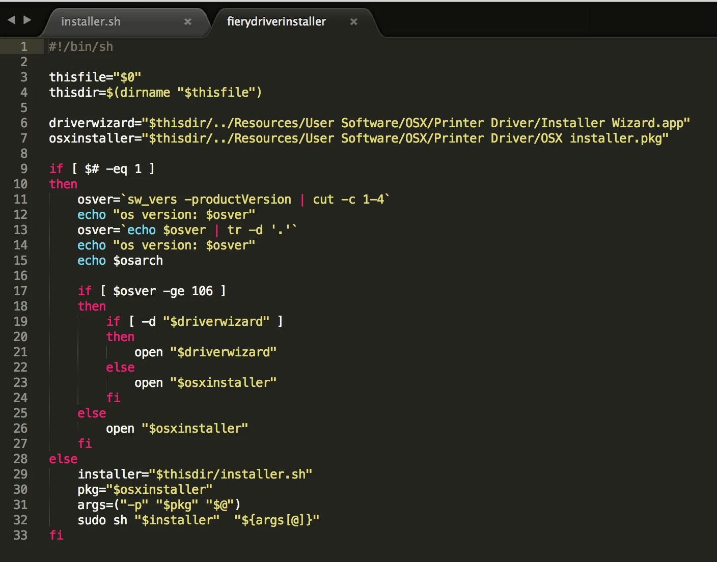

Thus you exhale a silent curse to the gods, and you proceed to unpack again the dmg to examine it more closely.
What you find is that there's actually two scripts in there, one calling the other.
There is, however, a glimmer of hope in the sense that installer.sh script can apparently be passed arguments.
If you look at the first image below, at line 31 to 35, you get to hope that if you type in the correct ip in there, along with the queue name 'print', locale would be, maybe 'en-US', then ppdname presumably the actual file name and finally printername what is set in the ppd itself I would presume again, then, in the end, after much presumption, you'd hope that would work.
Reinventing the wheel is always a tedious and rather pointless affair, so please allow me to ask if anyone ever actually DID deploy the current fiery drivers using any kind of automation. Any guidance and help for a first timer is appreciated. Just asking for the location of the usual booby traps and that sort of thing.
I'm asking this since EFI failed to provide me any documentation, and I couldn't find anything online that would help. I'm asking anyone here to share with me, us, how they went about deploying Fiery drivers and avoiding any windows from appearing.

# Canon printer configurator by Brad Chapman
# First step: remove existing printer on the local Mac named $4.
/usr/sbin/lpadmin -x "$4"
# Now add the printer using lpadmin
# Script Parameters:
# $4 = printer hostname (not the FQDN, edit this below)
# $5 = user friendly "location" string
# $6 = PPD file location, something like /Library/Printers/PPDs/Contents/Resources/HPLaserJunk1234-MFP
# $7 = list of printer options, i.e.: -o EFGAFeaturesOpt=GA1 -o EFFinisher=Booklet -o EFPaperDeckOpt=Option3
/usr/sbin/lpadmin -p "$4" -v "lpd://$4.corp.pretendco.com" -D "$4" -L "$5" -P "$6" -E -o printer-is-shared=false $7
You should play around with the file location $6. Even though the full path contains .gz, I found that it wasn't needed or implicit.
Hope this helps!

@AdminIA : you would need to deploy the drivers to the target computers first. I do it as a policy with two parts: the driver package, and then the script running "After." The script can be used to install any type of printer as long as you can identity the path to the PPD.
FWIW, when I have installed Fiery drivers from Terminal using the 'installer' command, the Install Wizard GUI does not appear. So far this has held true for iPR G100 and G200 fiery controllers.
stevewood
Forum|alt.badge.img+38
  • July 22, 2019
@AdminIA
We deploy a lot of Fiery printers and for as long as I remember, the GUI does not pop-up when using Jamf to push install the driver. My process for a Fiery is:
  1. Identify the right driver for the Fiery. (Shameless plug for my blog) - Identify EFI Fiery Driver
  2. Package the driver for deployment using AutoPKG and @foigus recipe: Trial By Fiery
  3. Upload the driver to Jamf and create a policy.
  4. Create a script to deploy the printer: Deploying Printers via Script and Using lpoptions To Identify Printer Options
As @bradtchapman mentioned, as long as you know the URI of the printer and the driver path, you can deploy any printer via the lpadmin command in Terminal.
The typical URI of a Fiery is: lpd://<ipaddress or DNS>/Print for the print queue or lpd://<ipaddress or DNS>/HOLD for the Hold queue.
Typical path for a Fiery driver, is /Library/Printers/PPDs/Contents/Resources/en.lproj or whatever language you need if deploying to other languages.
Hey @stevewood and @bradtchapman , thanks for your responses. I re-re-read them, checked out the links, and got things working finally. I have a gremlin in my script, and the path to the Fiery PPD wrong. Once I straightened that out and tested, it was working as expected. I appreciate the hand-holding.
