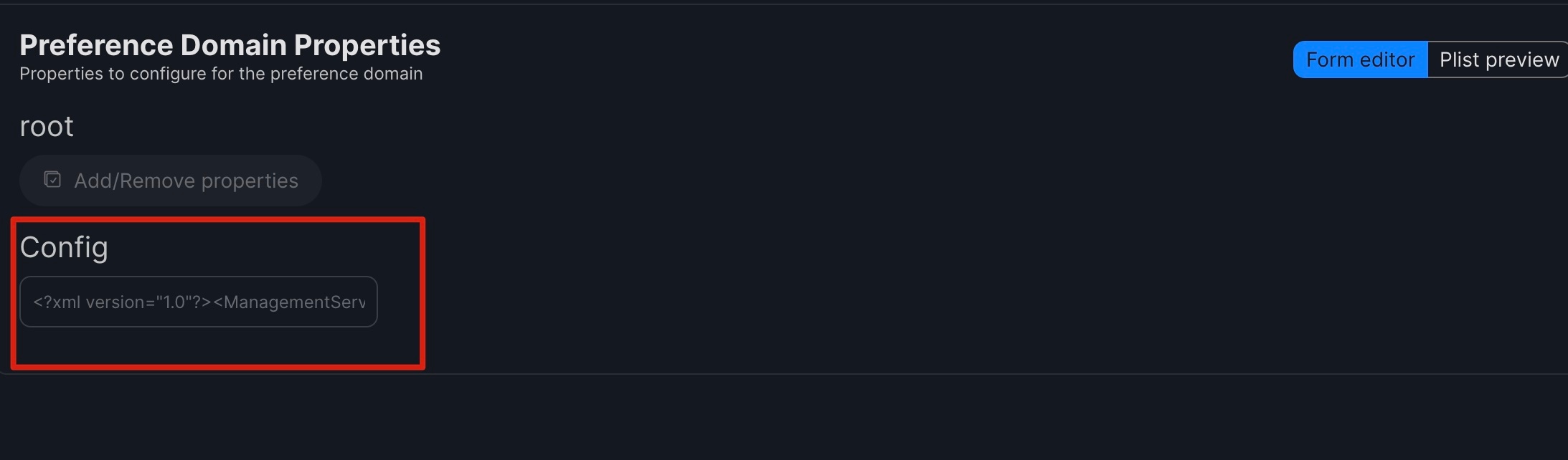

Hello,
I might be late to the party, but here is the solution, please let me know if it works for you.
A. Installation
The installation is performed in the exact same way as you would install any other .pkg via JAMF. If that does not work for you, please provide more details.
B. Configuration profile
In order to push VBR config file onto your Mac machines, you need to create a configuration profile:
1. Go to "Configuration Profiles" in JAMF console
2. Click "Add New".
3. Once you are done with filling in general settings, in the ribbon on the left side pick "Application & Custom Settings" - "External Applications":
Source = Custom Schema
Preference Domain = com.veeam.Agent
4. In the "Custom Schema" section click "Add Schema", enter these lines:
{ "properties": { "CatchAllConfig": { "type": "string", "title": "Config" } } }
5. In the "Preference Domain Properties" add the contents of xml config file that you got from a VBR protection group "Package" step, example:
<?xml version="1.0" encoding="UTF-8"?> <!DOCTYPE plist PUBLIC "-//Apple//DTD PLIST 1.0//EN" "http://www.apple.com/DTDs/PropertyList-1.0.dtd"> plist version="1.0"> <dict> <key>CatchAllConfig</key> <string>&lt;ManagementServerConfiguration Version="1" VbrInstallationId=..<I SHORTENED THIS PART>..SelfDiscoveryOptions /&gt;&lt;VbrCatchAllInfo /&gt;&lt;/ManagementServerConfiguration&gt;</string> </dict> </plist>
Your profile for Veeam Agent is ready. Once JAMF distributes it, all recipient machines that have Veeam Agent installed will contact the backup server that is specified in the xml and obtain all required settings.
C. Full Disk Access
This is also configured via configuration profiles. It can be either a separate profile, or the same profile that you used to distirbute VBR configuration.
You need "Privacy Preferences Policy Control" section:
Identifier = 'com.veeam.Agent'
Identifier Type = 'Bunlde ID'
Code Requirement:
identifier "com.veeam.Agent" and anchor apple generic and certificate 1[field.1.2.840.113635.100.6.2.6] /* exists */ and certificate leaf[field.1.2.840.113635.100.6.1.13] /* exists */ and certificate leaf[subject.OU] = NX3JU8SRVL
In the "App or Service" section pick "SystemPolicyAllFiles", "Allow", save.
Save the profile. Done. Now you can see the profile on your Mac machines in "Settings" - "Profiles"

Hello.
Are we supposed to paste the config from the Escaped or the deployment group .xml created with the package from the Veeam config or does it go somewhere else? Thank you!
dvasquez
  • Jul 15, 2024 3:03 PM UTC
This is still relevant in 2024. Works perfectly using the *._escaped.xml .  Hint: after following your example #5 verbatim, cannot stress enough how following your example exactly was our success. Thank you!
Ok so the escaped.xml
Trying now.
dvasquez
  • Jul 15, 2024 3:10 PM UTC
Hello.
I have the items in place and the laptop is not visible in the protection group.
Agent has been installed.
Profiles deployed.
Going to restart and go from there.
Thank you.

I just deployed Veeam 2.2.0.81 on a couple test Macs. Also deployed a TCC/PPPC profile (Full Disk Access), a Notifications profile, a Managed Login Items profile. and the my org's Protection Group config file. Looking good.
Questions
1 I keep seeing escaped.xml  version file mentioned. I was unable to use the escaped.xml - I had to use the normal xml file, otherwise the Mac agent would never register. Why did you need the escaped.xml? Wonder what Im missing?
2 I cant seem to perform on-the-fly backups from the Veeam admin console. The 'Backup now' button is grey.
3 Is a dedicated service account required on the Mac endpoints, or do the jobs run as root without needing a Veeam admin account?
