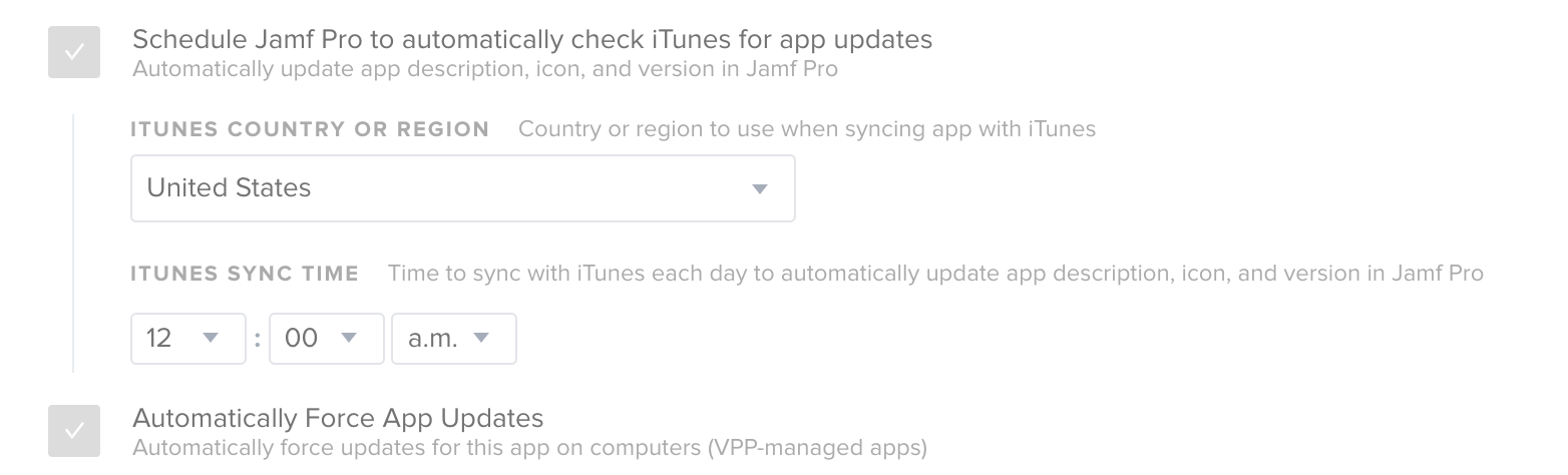

Yeah mine are hit or miss with how long Xcode takes to install. I'm running into an issue now trying to get them all updated to 11.1. I used device-based VPP assignment but trying to use the Force Update option doesn't seem to be working for my computers. Anyone know if when using device-based assignment if I should have users set to All Users or Specific Users then leave it blank? I just read through the documentation and it doesn't say one way or the other.

Hmmm. I've got Xcode deploying through the Mac App Store Apps management tool. I think for now I'll set the install script to run monthly and hopefully that will be often enough to keep everything up to date. I can always flush the policy if I discover that the computers need authorization again.
  • February 21, 2020
@kacey3 how well is your Xcode policy working? I am revisiting this issue once again with the 11.3.1 update for Xcode because only a handful of my computers are updating. I logged into three of them to test things again and they started to download the updated version automatically, but the teacher is reporting that when his students log in they don't get anything.
