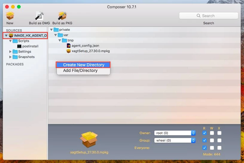

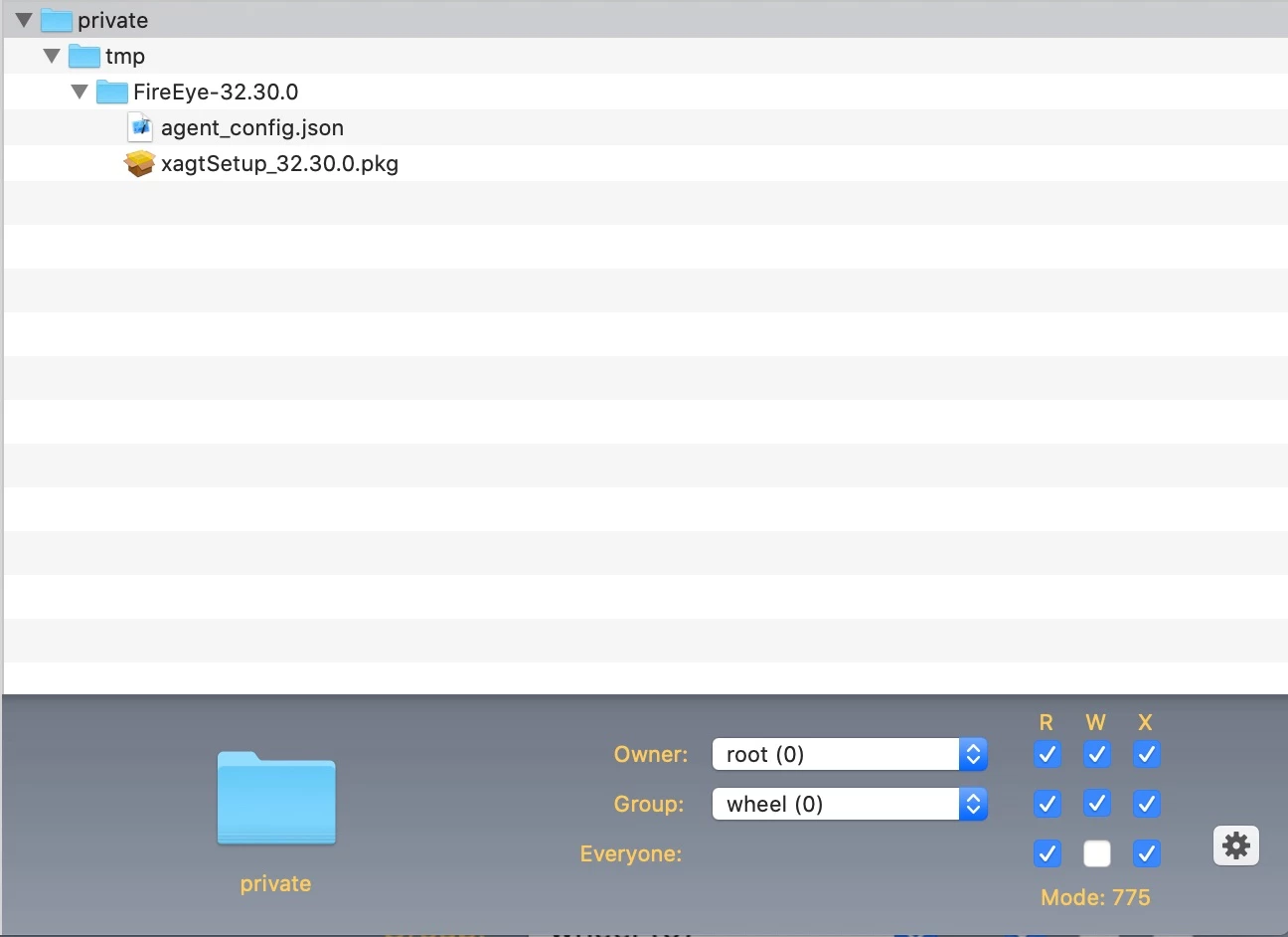

This is how I managed this, hope it will help you.
On the MacBook, start Composer:
Drag and Drop the FireEye agent .dmg file in composer, Click Convert to Source
Click "IMAGE_HX_AGENT_XXX" and create the directory /private/var/tmp/
Drag and drop both agent_config.json and xagtSetup_XX.mpgk files in /tmp as below :

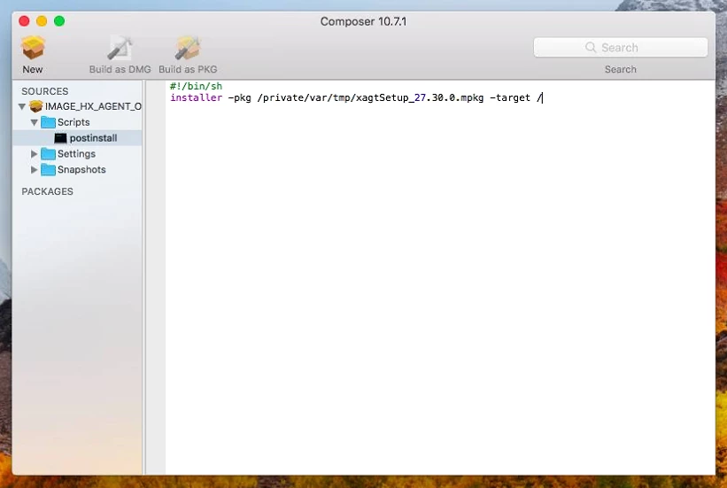

Create a postinstall script:
Right-Click on Scripts > Add Schell Script > postinstall
Add this command in the script, modify it depending on the version you want to package (adjust the file name depending of the version) :
installer -pkg /private/var/tmp/xagtSetup_27.30.0.mpkg -target /
Click "IMAGE_HX_AGENT" and Save the configuration
Build the pkg file
Save the file in the desktop
The package has been generated
You can test the package installing it manually on the MacBook.

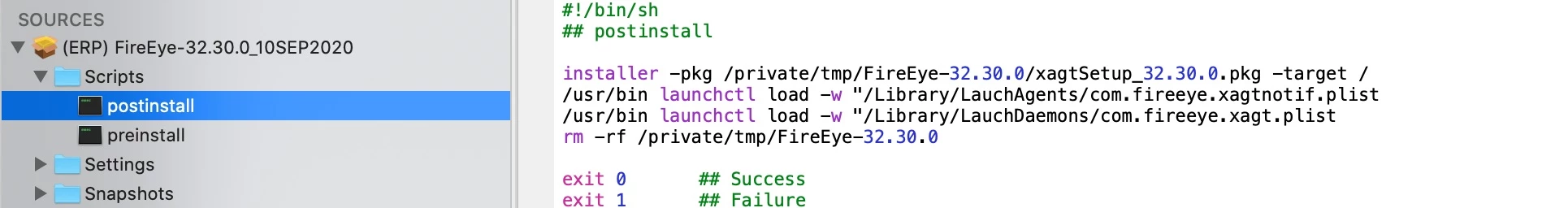

@omaromar I ran into this when we upgraded to version 32.30.0. We deployed it and with Jamf, and Jamf does show the latest version via the EA. I confirmed the agent was running in Activity Monitor, but the FireEye folks said the agent didn't update.
What version of macOS are you running?
Here is what I am doing. After installing FireEye, try a restart and see if it reports the new version with the FireEye Team. Also, go to System Preferences/Security & Privacy to see if you need a "Bitdefeneder SRL" Kernel Extension Approval. If so, you'll need to create and push this config profile.
In my FireEye package, I added the postscript listed above to load the agent and daemon. When i added this to the package, I didn't have to restart for Macs using 10.13 (maybe 10.14?) and up. Older Macs I still had to restart regardless.
/usr/bin/sudo launchctl load -w "/Library/LaunchAgents/com.fireeye.xagtnotif.plist"
/usr/bin/sudo launchctl load -w "/Library/LaunchDaemons/com.fireeye.xagt.plist"**

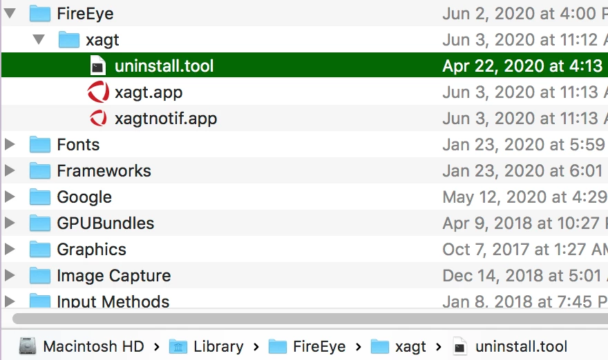

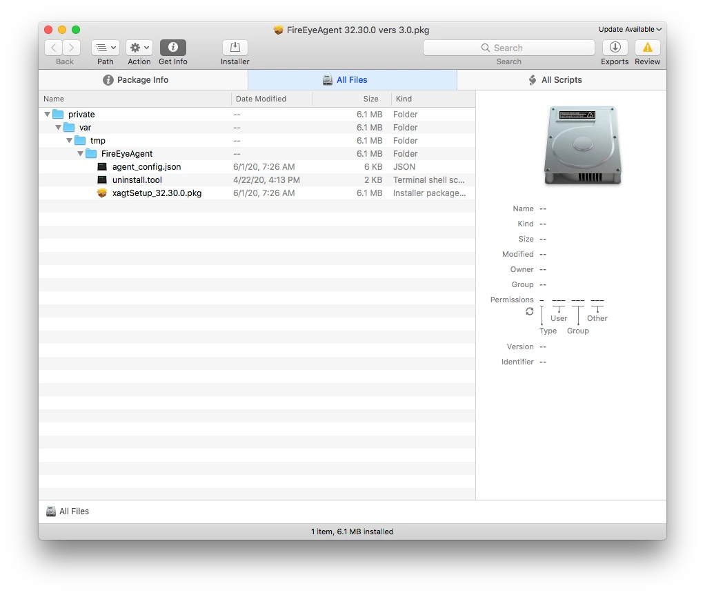

@omaromar I was playing around with this and ended up adding the uninstall FireEye script to the package. Before, it looked like the package ran successfully, but the EA reports "Not Installed" for some machines.
On a computer that you know has FireEye installed correctly, go to: Library/FireEye/xagt. Here, you'll find the "uninstall.tool" script that does a good job of deleting everything FireEye. From there, you'll just need to repackage and add one postflight line to the script.

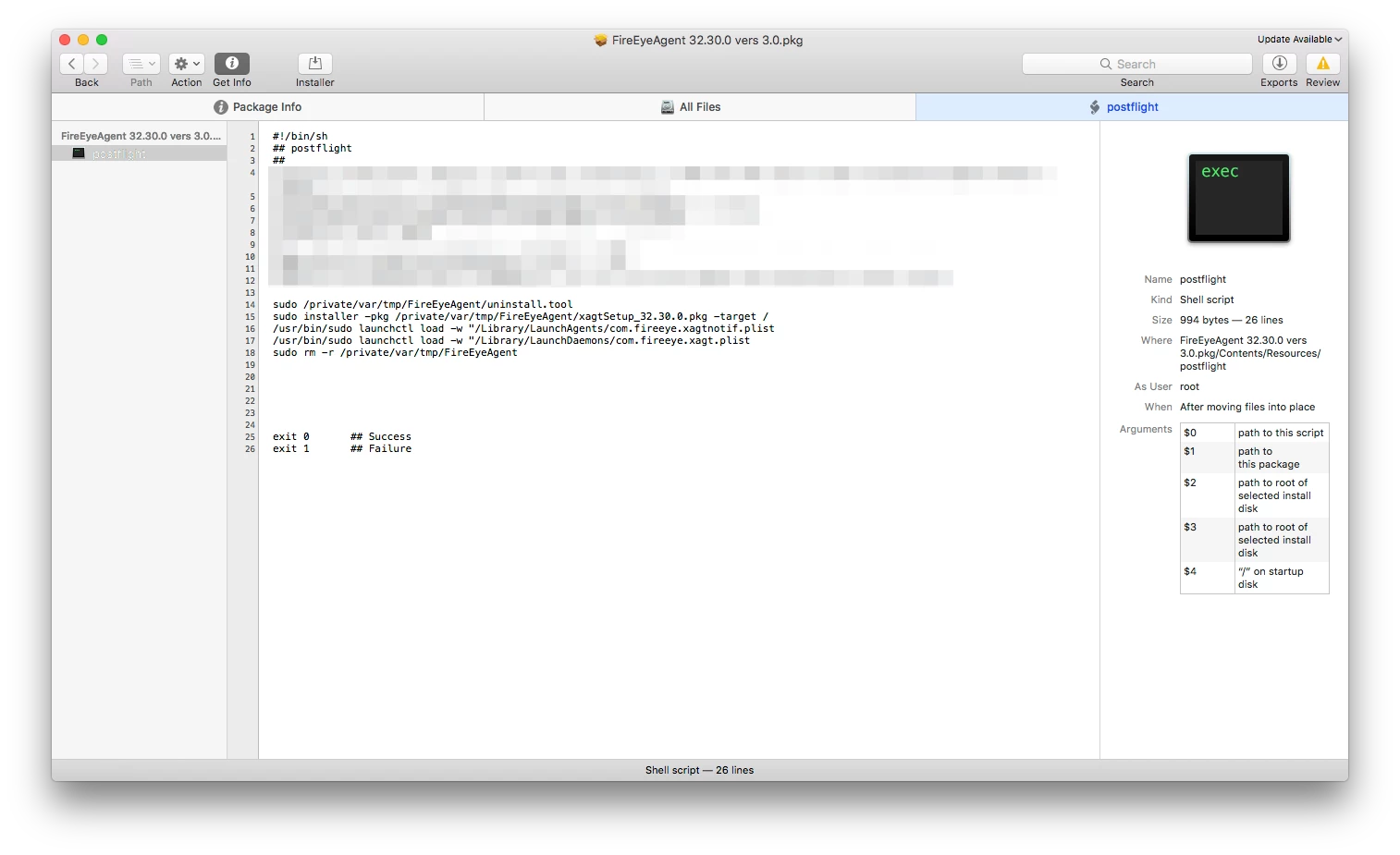

Hello @mvu
This is what I have at the moment, sent it to five machines, and will check tomorrow to see if 1) Jamf says it was successful and 2) If our FireEye team can see them reporting in the console. I appreciate your help and guidance on this, let me know if what I have is okay or needs correcting.

@omaromar Your package will work most of the time. But we found it failed in some instances, even though Jamf Pro said it installed correctly. Comb over my last post about adding the uninstall script/tool to the package, and then adding a line in the post flight to run this.

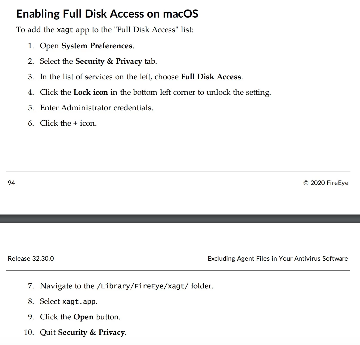

Something else FireEye suggests is enabling FDE (Full Disk Encryption) for the agent. I stumbled upon this and wanted to share and get anyone's opinion on this.

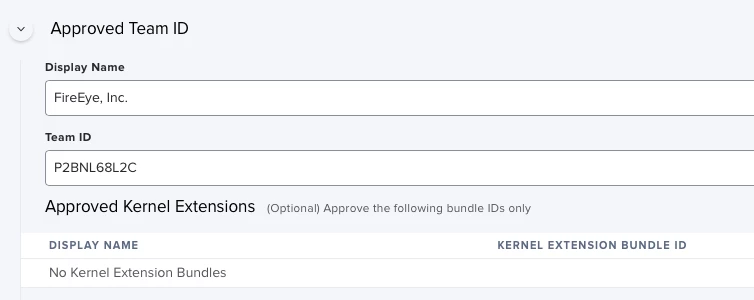

@omaromar I don't know about FDE, but yes, you do need TeamID/PPPC Approval set up before FireEye can install and run.
  • Sep 11, 2020 4:16 PM UTC
@mvu, I have that in "Configuration Profiles" already. This is from their documentation, of course I can do this locally, looks like I would need to do this Globally as well. Just wondering how it's done via Jamf | Pro?
mvu
  • Sep 11, 2020 4:21 PM UTC
You'll need to create a PPPC for xagt.app using the PPPC Utility application. Once you spit that out, upload the file to Jamf Pro.

Setting up FE for the first time .. two quick questions:
- Do I need a PPPC for both xagt.app and xagtnotif.app for full disk access?

For the uninstall tool, I added it on the last version upgrade. I noticed when we upgraded the FireEye Agent, some Macs failed to upgrade. So, I added the line to do a clean uninstall first, then install the latest/greatest version of the agent. This provided a consistent install across the board, so please test in your environment.
  • Mar 30, 2021 4:32 PM UTC
@mvu I created this TCC profile in PPPC Utility, but xagt.app does not show up in the Full Disk Access section. Does that matter?
mvu
  • Mar 30, 2021 7:24 PM UTC
I would still push the TCC Profile just in case. You can test both ways.
