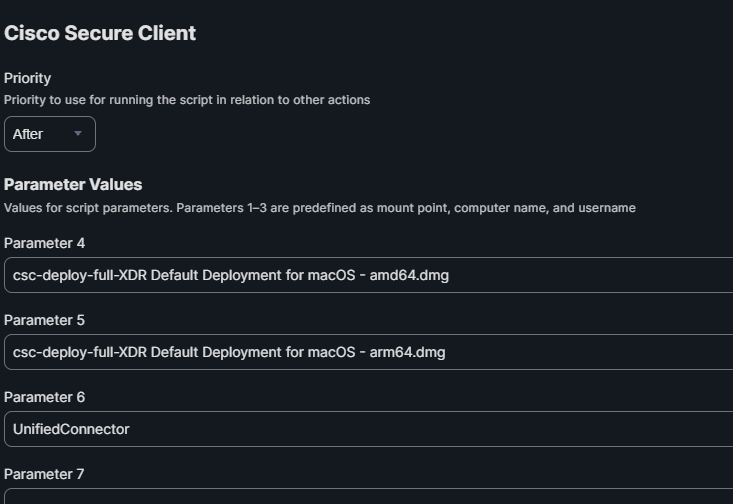

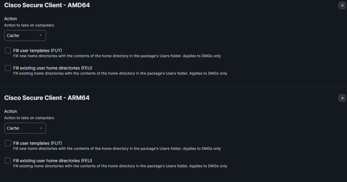

Create a policy for the Cisco XDR installer and add the 2 dmgs to the packages and set them to cache
Then add the script to the policy and enter the information matching the dmg file name and the name of the mount.
