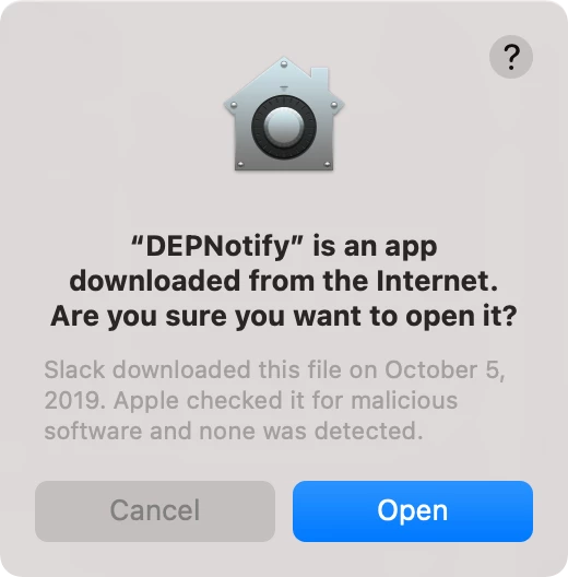

Anyone testing DEPNotify and Big Sur? I am using it in a prestage for DEP and a policy for manual enrollments, but I am prompted on both to accept the Application as it was downloaded from the internet.
(I did not download this from slack from the DEPNotify creators GitLab)

remove the quarantine flags from the file/app
xattr -d com.apple.quarantine /path/to/DEPNotify.app
This will then remove the quarantine flag from the file/object and Gatekeeper will not prompt you

that will work with any pkg you download from the web. If you remove the quarantine flags GateKeeper will not prompt you. It will work this way on all packages until Apple changes this behavior

I did perform the command on the .pkg file (on a Mac with Catalina) and DEPNotify still prompted to accept on the Big Sur beta computer.
additionally, if I let the prompt sit there for a while, DEPNotify does install and appears it does run through the policy triggers (not DEPNotify screen at this point, I see things show up in the Apps folder, etc), so when I click open, it takes me to where ever DEPNotify is in the process.

@walt, I think what @tlarkin is suggesting is to have a script run the xattr command after the DEPNotify.pkg is deployed. Since Jamf allows us to easily run scripts in any policy after a payload is deployed, it should be an easy thing to add in to whatever policy is pushing out your DEPNotify.pkg. Or even just drop into the Execute Command field.
Another option would be to do what you stated and simply repackage DEPNotify yourself, making sure of course that the Apple quarantine flag is removed before doing so, but I would be careful with that, since unsigned packages could cause trouble too. If I'm not mistaken, the main DEPNotify.pkg from Orchard & Grove is signed with their developer certificate, so it would probably be safer to use theirs. Unless you have your own dev certificate you can add to the manually created package that is.

nope just run the xattr command before you upload it to jamf. macOS only quarantines files downloaded from apps and browsers and not from anything that uses API/ABIs, like curl for example

The xattrs are attached to the DEPNotify app in the .pkg, so clearing them on the .pkg itself shouldn't help. Either clear after the app is installed, or re-package and specify that xattrs aren't preserved (if you use Composer it has no option to preserve xattrs as of 10.23)

So, anything downloaded via web browser Apple flags with a quarantine meta data tag to tell GateKeeper to inform the user it was "downloaded from the web". You can check it by doing this
xattr DEPNotify.pkg
com.apple.metadata:kMDItemWhereFroms
You can see it has the quarantine flag. If you use xattr you can delete it. When in doubt just google search @rtrouton 's blog

@tlarkin just added that to post install script works fine now.

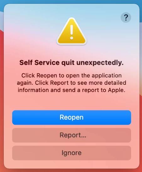

though I got to figure why self-service is crashing post enrolment when depNotify kicks it in, I get presented with this prompt to reopen it.
  • December 13, 2020
Using 1.1.6 depnotify got rid of that.

Ok, i was wrong Self-Service still crashes and prompts to reopen, DEPNotify works fine though when relaunched, still no clue about this. :(
