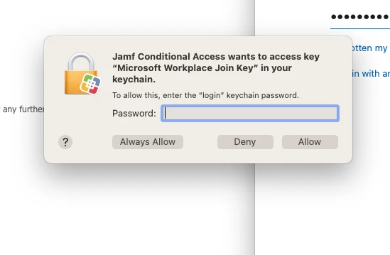

I see microsoft wokplace join key in keychain but browser didn't used it.
This picture what you sent I had when I stared enrolment policy form self service.
Then I gave a password and "always allow" box.
After that I logined to portal office on chrome or safiri, but in azure logs I didn't saw device ID or device marked like complinance.

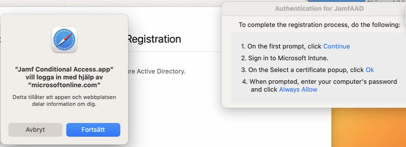

I have just (a few days ago) implemented this on one of our customers (still at testing from us though thank god) but we are facing similar issues. The Device Compliance is setup and all is good on that part. It works when registering a device with "Microsoft Device Compliance" payload policy except it doesn't always. So when running the registration through self-service i get this (below picture).

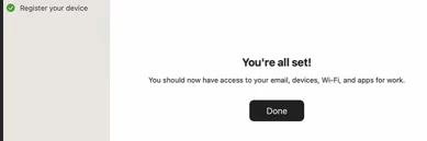

All is good, and you can see the device in Azure AD under devices. Except once you press the "Done" button following is supposed to show up:
And this is my problem, this JamfAAD authentication does not show up everytime. It's very random.

It is working sometimes, i have gotten it to work where the JamfAAD pops up, but reinstalling my test machines and registering to intune again through self-service "Microsoft Device Compliance" payload it didnt pop up. Then after a couple of hours, i ran to register again through self-service then it popped up.
Anyone have any ideas? Same problems?
