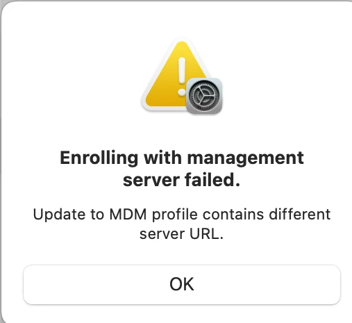

I tried to update the MDM Profile by physically going to the device and running "sudo profiles renew -type enrollment" but I end up getting the following error when I attempt to apply the update.
At this point I am stuck.  Not sure what the error means.

Does running a "sudo profiles renew -type enrollment" fix anything?  I've used that when I get the "New profile does not meet criteria to replace existing profile" error.  Usually I go check that the management account credentials are correct or even there in the computer record as well.

I'm also seeing weirdness on wiped machines as well as existing machines that give a device signature error (run recon through terminal).  What I've found I had to do was send a remove MDM command from Jamf Pro, and then when all the profiles are removed, I can then go back and manually enroll it and then everything starts working.  This has become almost a daily dance in our environment for net new/reimaged/machines dropping jamf DB connections.
