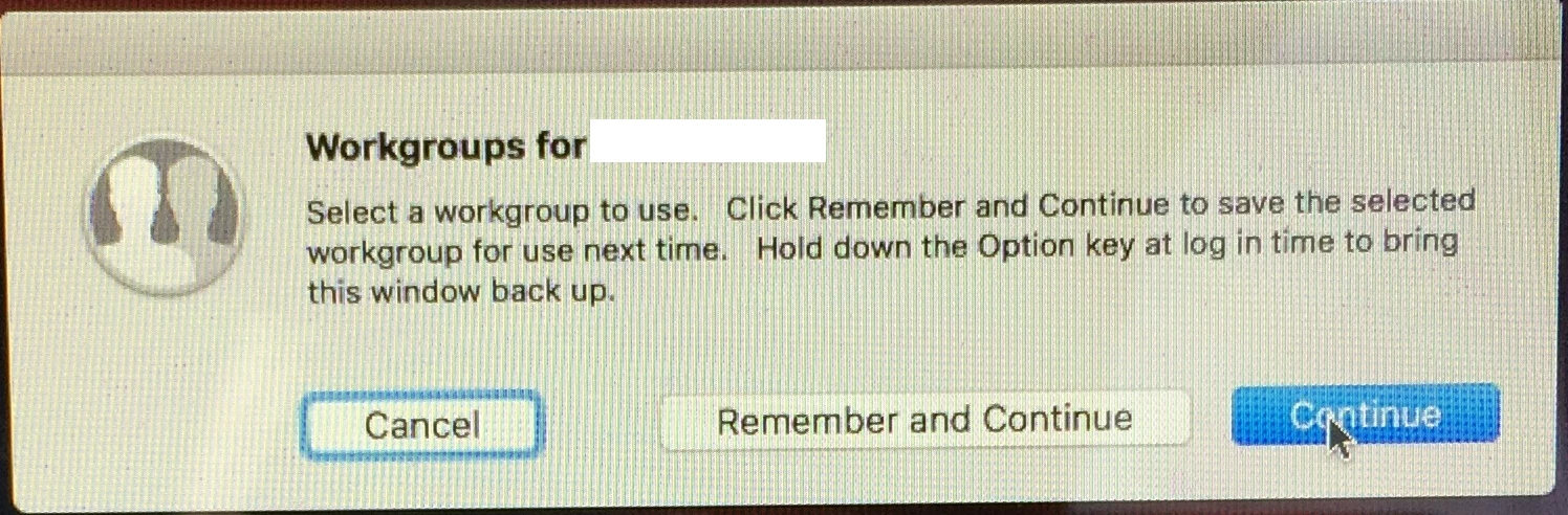

I've been testing Directory Bindings on 10.12 with weird results. Was testing with 9.93 and just upgraded to 9.96.
I'm using a script to bind macs to our AD domain so can't comment on the JSS' built in directory binding but seeing the following:
When logging in a prompt for "workgroups for <username>". Doesn't matter if I click "continue" or "Remember and continue", it keeps popping up every logon. This happens for local mac accounts and AD domain accounts.
When logging in with a Domain Account, it isn't creating a mobile account. There is a button in Users & Groups to convert it to a mobile account (despite having the "create mobile account at login" checkbox checked). Clicking this button to create a mobile account was working on the last dev preview I had tested, but it seems to not be on the GM release. The AD settings seem to be ignored by macOS 10.12 at this moment.
We're not using portable homes i.e. syncing the home to a network server, just local directories on the mac.
I'm just trying out our build process with 9.96 to see if there's any change but I doubt it. Anyone else see anything similar?
