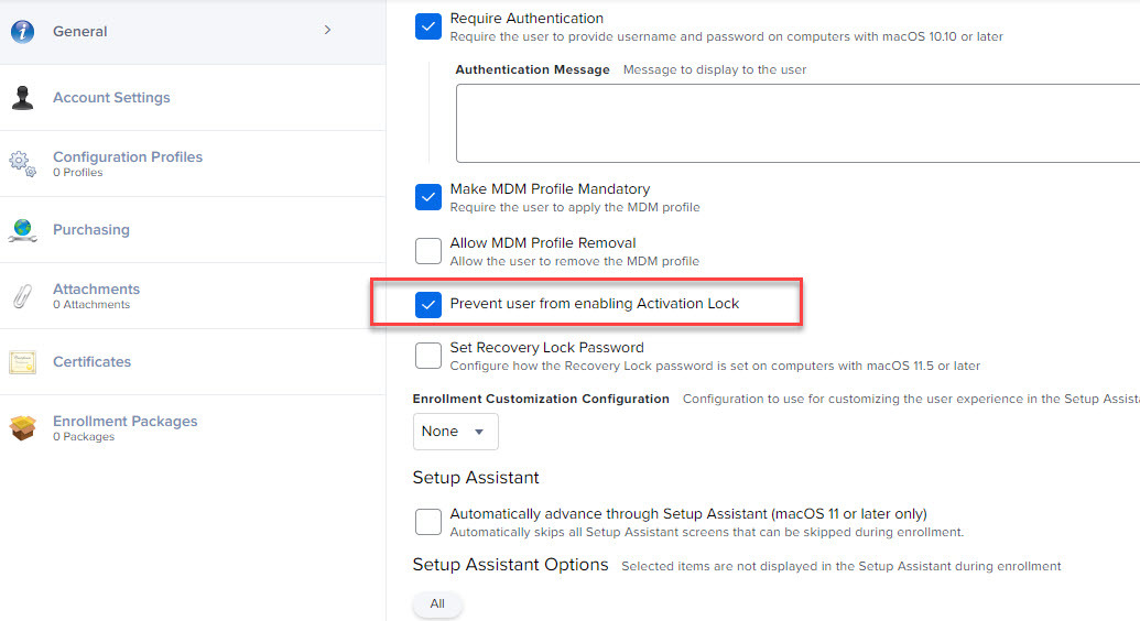

As Bmcdade said, there is no way to disable activation after the user has enabled it. If you can not get ahold of the person who has it activated to their apple ID you can try contacting apple support. Its a long process and sometimes they will not unlock. The way to prevent users from enabling activation lock is to use the PreStage setting: Prevent user from enabling Activation Lock,  that disables activation lock from turning on when a user signs in with their apple ID on the new/wiped device.
After you make the PreStage change, for existing systems you should create a computer search that checks for activation lock (Activation Lock Status enabled). Run a Jamf action against it: Send Remote Commands > Set Activation Lock (Supervised or enrolled via a PreStage enrollment) > Disable and prevent Activation Lock. This will prevent future activation locks (but not disable the current one). Then contact the user of each device and ask them to sign out of their Apple ID (in system preferences) Once signed out, the can sign back in. The Disable and prevent activation Lock will stop activation lock from re-activating.
