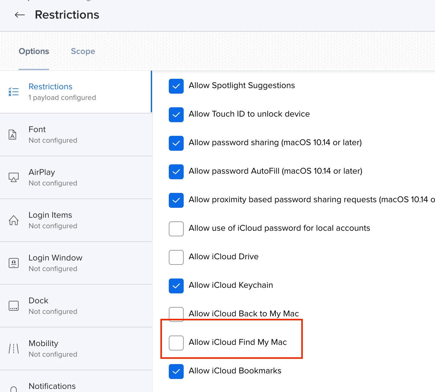

I set a Restrictions configuration profile to disable Find My Mac. I ensured that I'm part of the scope and that the config profile actually installed on my machine. My machine is checking in with no problem. However, I'm still able to turn on/off Find My Mac after the Restrictions profile is installed
Anyone having this issue or recommend a better way of disabling? What scares me the most is a user being able to remote wipe their Mac without IT's consent.

This has been an issue since Catalina. You need to create a manual profile with the following setting. Also, if its already enabled, there is no way to automate to turn it off.

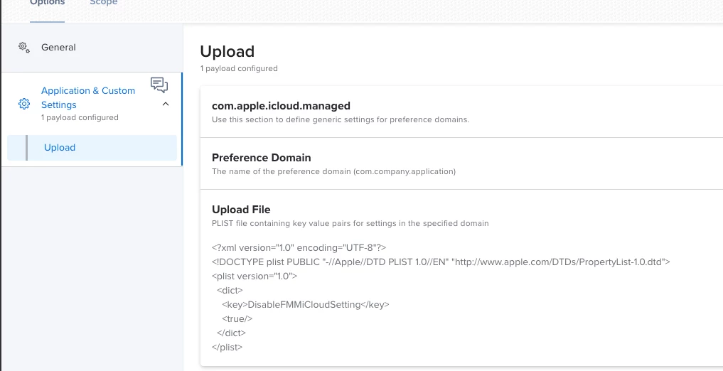

hey @spoe everything you need can be seen in the screenshot. You'll need to create a plist file with the below and then upload it.
<plist version="1.0">
    <dict>
        <key>DisableFMMiCloudSetting</key>
        <true/>
    </dict>
</plist>

This will only gray out the option to turn on FindMyMac.

There has been a bug in the payload from Jamf for disabling FindMyMac since Catalina. This is just a way to make sure the option is grayed out like it should be if using the payload in the Jamf Restrictions Payload.

@dpwlg use the following EA (name it FindMyMac Status):
fmmToken=$(/usr/sbin/nvram -x -p | /usr/bin/grep fmm-mobileme-token-FMM) if [ -z "$fmmToken" ]; then echo "<result>Disabled</result>" else echo "<result>Enabled</result>" fi
Create a Smart Group:
  • name: FindMyMac Enabled
  • (criteria) FindMyMac Status (operator) is (value) Enabled
Create a Configuration Profile:
  • name: Disable iCloud FindMyMac Option
  • Application & Custom Settings
    • domain: com.apple.icloud.managed
    • Upload File (copy & paste the following):
<?xml version="1.0" encoding="UTF-8"?> <!DOCTYPE plist PUBLIC "-//Apple//DTD PLIST 1.0//EN" "http://www.apple.com/DTDs/PropertyList-1.0.dtd"> <plist version="1.0"> <dict> <key>DisableFMMiCloudSetting</key> <true/> </dict> </plist>​
  • Scope:
    • Targets: All Managed Clients (or relevant scope for your use case)
    • Exclusions: Smart Group: FindMyMac Enabled
Once the config profile is deployed you will be able to then contact the computers that show in the Smart Group "FindMyMac Enabled" (view > export csv). Once they disable FMM on their machine > have the computer check in to Jamf (sudo jamf recon or wait until next check-in) > It will then move them to the Config Profile and grey out/lock FMM in iCloud settings.
