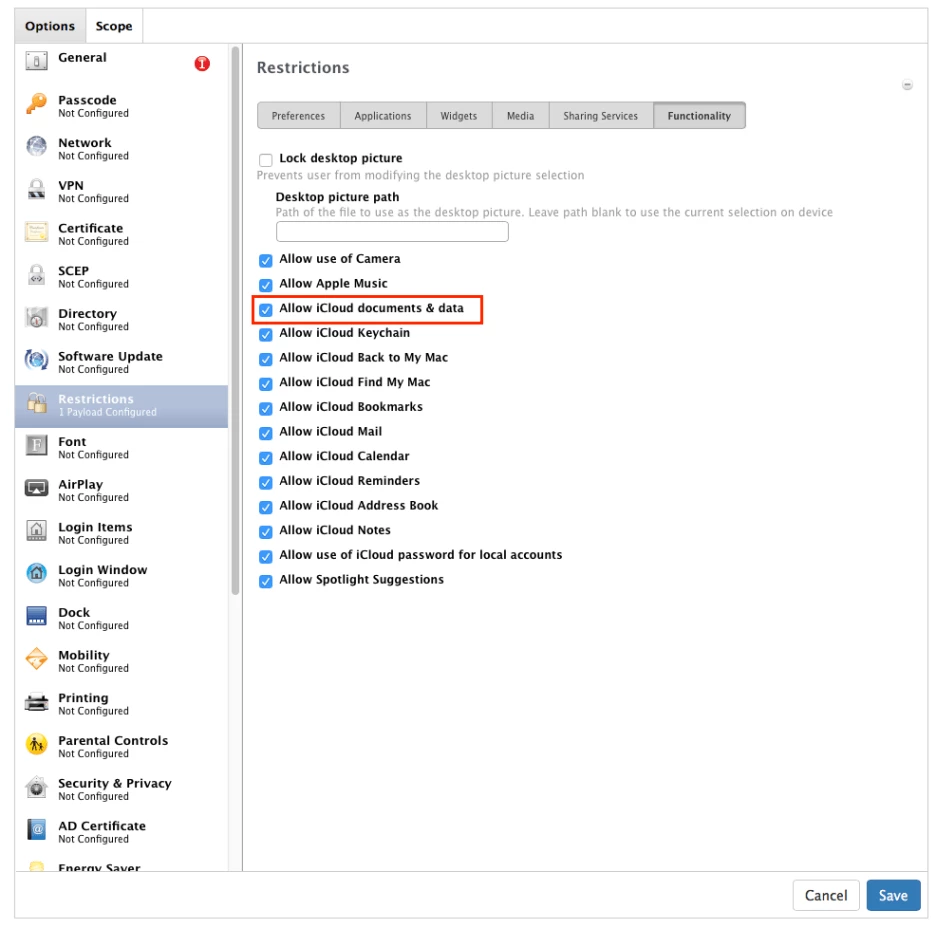

This option is also available in Casper 9.96's profile options, by unchecking Allow iCloud documents & data:

Can anyone confirm if the new setting in 10.12.4 works as intended? I've had the profile applied and it does disable my ability to turn on Document and Desktop syncing; however, when I reboot the computer iCloud Drive is disabled on reboot.
I'm seeing this same behaviour.
Instead of using the profile from Jamf I built a config profile from scratch and it exhibited the same issue. On 10.12.4 and 10.12.5 the same behaviour exists.

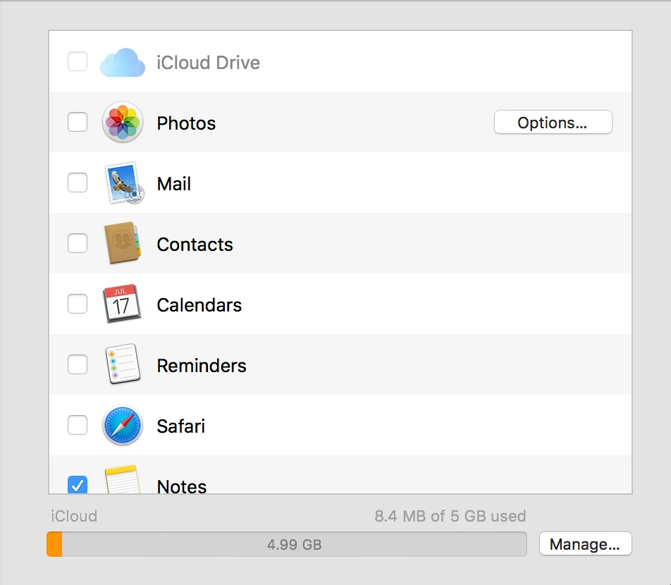

I've got the same issue Dmitry. I don't need iCloud Desktop or anything, and would prefer to keep that disabled, but I use Bear (http://www.bear-writer.com/) for all my writing, note taking, and task lists, and I use both the macOS and iOS apps. Bear uses iCloud Drive to sync my notes across devices, but with the macOS 10.13.3 rollout, our new policy restricts iCloud Drive by default – it's greyed out under iCloud preferences:

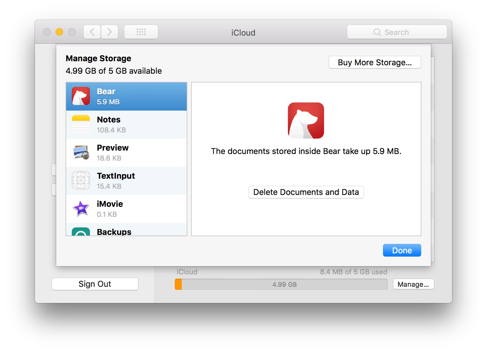

I have admin rights on my MBP, and deleting the profile allowed me to sync last night, but I checked back in this morning and it was greyed out once again when I did so. The underlying data are still there:
Deleting profiles, syncing, and reinstalling profiles isn't going to be a reasonable solution to this issue, but I'm afraid that with frequent policy checks between my MBP and the policy server (hourly when on campus?), I'm hosed unless I can convince the powers that be to either a) enable iCloud Drive just for me, or b) allow iCloud Drive for certain apps, but to disable it for Desktop and Documents only so that I can use Bear on my phone and on my MBP with syncing between the two.
I'm able to edit .plist files and save changes, but the preferences are immediately overwritten, and I'm not even sure I was editing the correct files – I am a developer, but I didn't know what jamf was this time last week (and frankly I still don't truly understand it). I wonder if there is a vulnerability that will allow me to allow the server to push its changes, but a way to configure locally such that the one flag disabling iCloud Drive is disabled. If there is, I certainly haven't figured it out yet...
@Dmitry and @phishjams You'll both need to speak to your sysadmins managing your Macs. Your iCloud settings are being managed with profiles and the profiles are working as expected. Your best bet is to ask your admins to exclude you from these profiles or create another profile with the iCloud options enabled just for you.
Has anyone found a solution to the issue with iCloud drive being disabled after a restart? I am seeing this behaviour also, and I do not want to block iCloud completely nor do I want to "Allow iCloud documents & data".
I am testing on 10.12.6. I'll check the behaviour on 10.13 tomorrow.
(EDIT: I tested on 10.13.3 and Jamf Pro v10.2.2 and it remains checked after restart, which is what we wanted)
