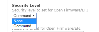

For anybody else with the same question, here's the JAMF doc for how to set the EFI password.
http://docs.jamfsoftware.com/9.96/casper-suite/administrator-guide/Administering_Open_Firmware_EFI_Passwords.html
  • October 4, 2016
To be clear, should this policy be scoped out to all workstations, or just the Netboot server?
Should I encounter any problems, is the EFI policy able to be pulled back easily by setting the Security level of the EFI configuration back to "none"?
