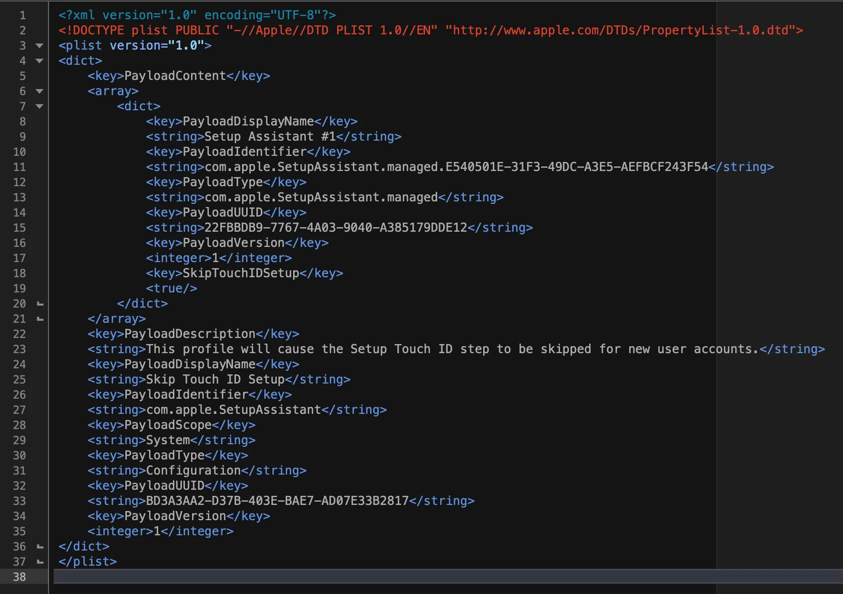

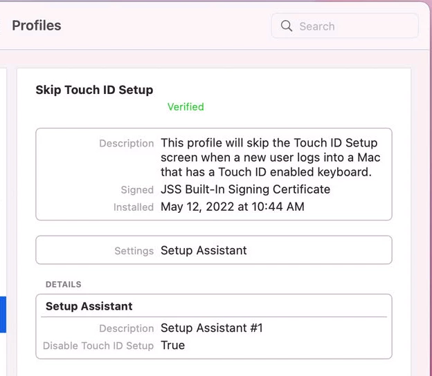

I had a chance this morning to re-setup the configuration profile and deploy it to a classroom that has M1 Macs in it.  This seems to be working properly for me.  On a computer where I do not have a user account already created, the setup touch ID step is skipped.  One thing that I did notice, is that the window tries to load for just a couple of seconds on the screen, but it never actually loads the contents of the window.  It just displays an empty rectangle where it would have the start of the steps and then disappears with no further interaction.
For creating this profile, I used the iMazing Profile Editor software.  The option is in the interface, you enable it and then give it the other info and save it out.  Then you import this into Jamf.  I'm sure you could do this by hand though since it is a short profile.
This is the mobileconfig profile when opened in BBEdit:
This is what is shown in System Preferences - Profiles:
 Hopefully that helps!

I don't think I have missed anything based on your description, but it still won't work. What are you using for the Preference Domain? I was using 'com.apple.SetupAssistant'
  • May 12, 2022
That is what I have put in the "Identifier" field in iMazing.  In the .mobileconfig file, it is listed in the "PayloadIdentifier" string value field.
