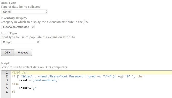

We have an Ext. Attribute that inventories the user accounts and various attributes of the account, whether they are local or mobile or if they are admins for example, and one of the things it checks for is if root is enabled:
if [ "$(dscl . -read /Users/root Password | grep -c '**')" -gt '0' ]; then
    result=',root-enabled,'
else
    result=','
We then have a policy with a one-liner which disables root, scoped to every machine that the previously mentioned EA has a match like ',root-enabled,':
dscl . -passwd /Users/root 'randomstring'; dsenableroot -d -u root -p 'randomstring'
'randomstring' is a randomly generated string of characters. It has to be the same in both commands, and I guess it doesn't technically have to be the secure since you're disabling the root account that uses that password for - but that line of thinking makes me nervous so I use an actual long string of randomly generated characters.

so i set it up a while ago, but none of the information is populating, i set it up as a script and added bin/sh
mm2270
  • April 2, 2015
No echo line with <result> </result> tags
  • April 2, 2015
Apologies, that was a code snippet for the whole EA. You need to echo out your result in brackets as @mm2270 points out. Let me see if I can clean this up a bit more for you and make it a little more useful.

ImAMacGuy
