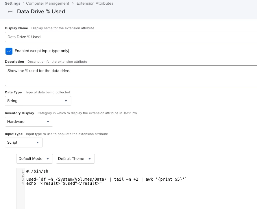

I created a custom Extension Attribute and then used a smart group with the EA as the criteria to monitor this. Hope this helps.

used=`df -h /System/Volumes/Data/ | tail -n +2 | awk '{print $5}'`
echo "<result>"$used"</result>"

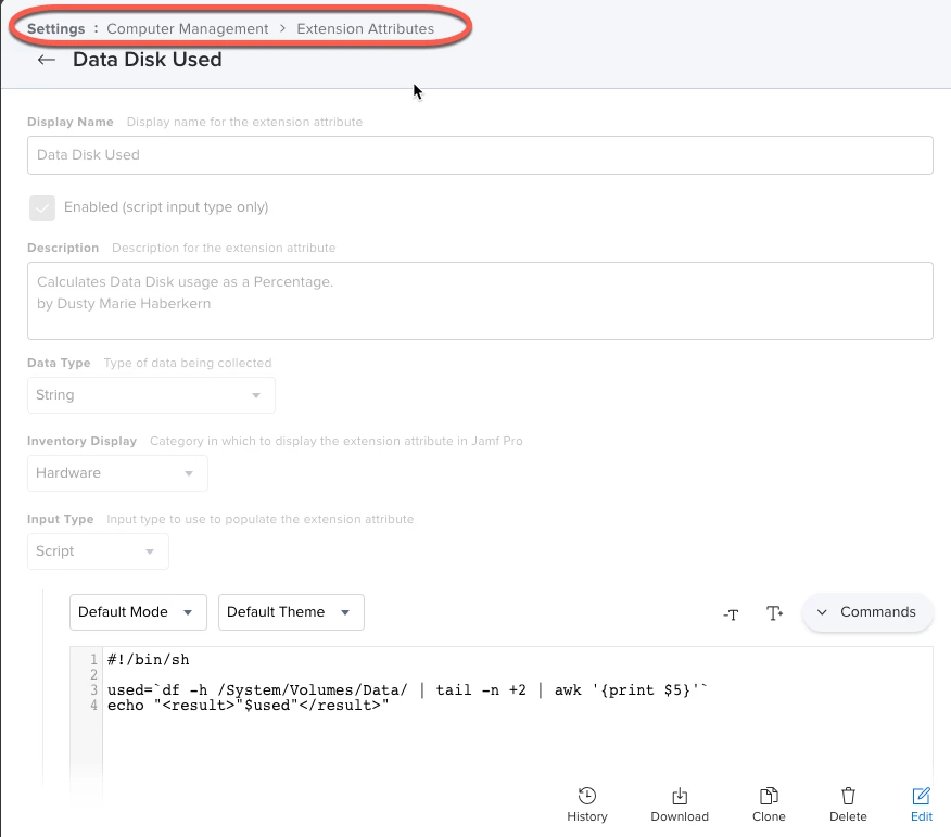

Don't forget it is an Extension, not a script... also I used String and not integer in my setup as shown here:

Look under the computer's Inventory, Hardware. At the bottom you should see Extension Attributes, Data Disk Used.
You can also add a column for All Computers Search to show all computers at once.

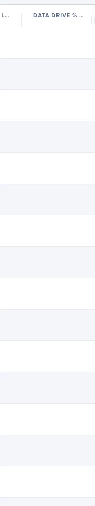

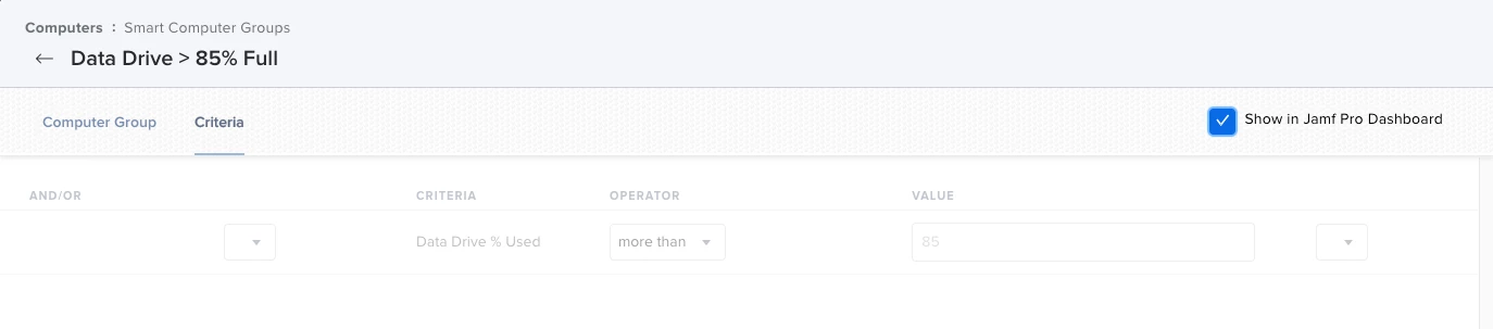

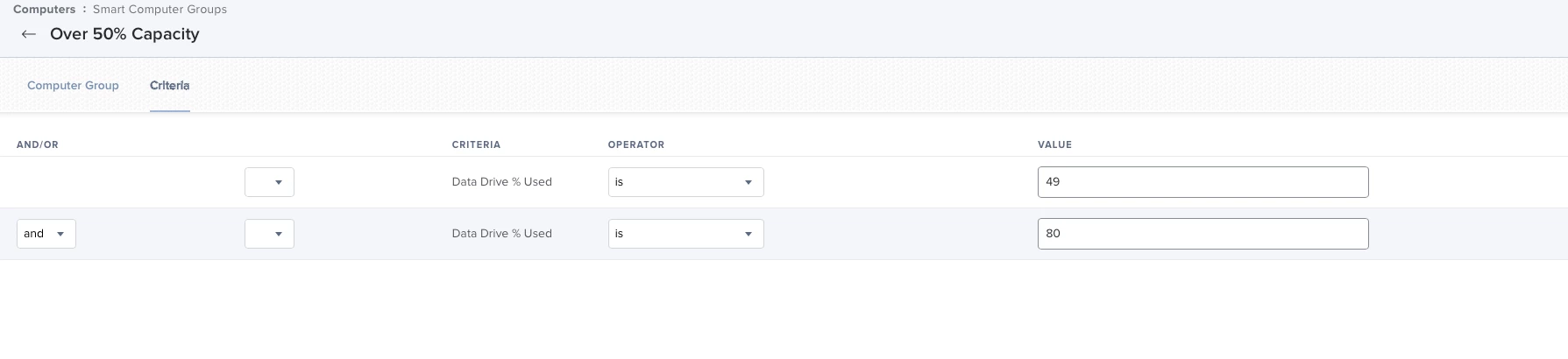

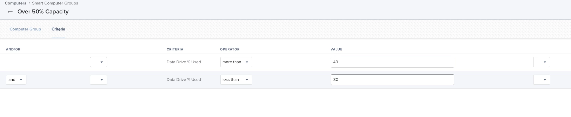

I added the column and it is empty. I also went back into the criteria for the smart group and it changed from "less than" or "more than" to "is". How would I get it back to the less and more than?
  • Apr 26, 2022 4:21 PM UTC
If you changed the data type in the Extension Attribute to string from integer that changes how you can interact with it in the smart group, that is why you now have "is" instead of the "less than" and "more than".

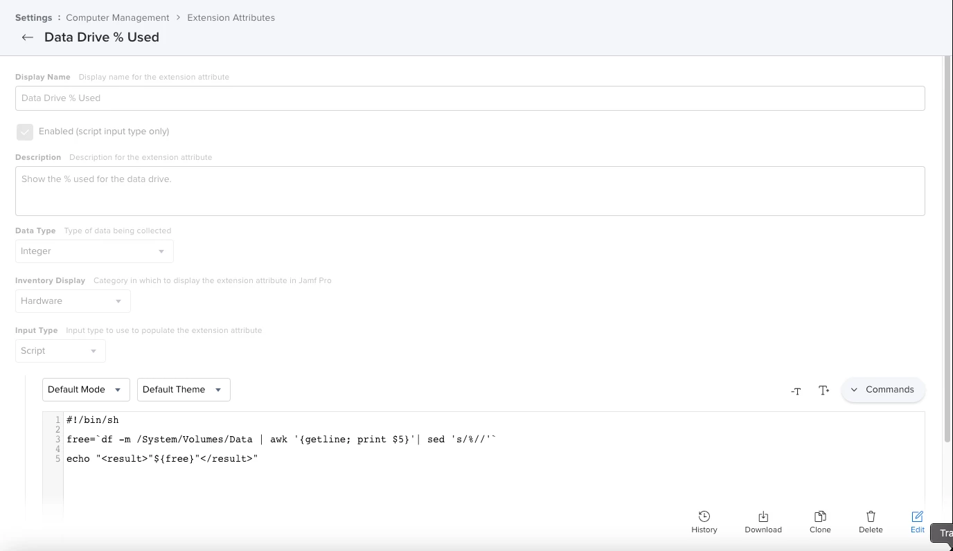

I see that DMH2000 has set their extension attribute a bit differently then mine. If you would like to try mine out I have pasted it here:
free=`df -m /System/Volumes/Data | awk '{getline; print $5}'| sed 's/%//'`
echo "<result>"${free}"</result>"
Additionally, Im not sure why you have the "less than" 80 in your smart group. I may just not understand what your aim for the smart group is but just setting the "more than" to 49 would be sufficient in showing the data drive being over full. I would suggest just for testing reasons set it up the same why that I have mine to see if it works then add additional criteria to the smart group.
If you have any question about this please let me know, hope this is helpful for you.

The reason I have that is that I also have a smart group that is "Over 80% Capacity". We use that one for a couple of other specific things that need our attention.
I now updated this with your parameters and it is still coming back as zero.

You could test out the command in your terminal and change the smart group to reflect the output. So if you run the command and it says "17" then change the smart group to if "more than" 16. May be a good way to see if it's working.

In my case, I had to drop the "%" from the script output since the Extension attribute is configured as an integer (number WITHOUT the % sign).
I modified the script DMH2000  provided to the below.
#!/bin/sh used=`df -h /System/Volumes/Data/ | tail -n +2 | awk '{print $5}' | cut -c 1-2` echo "<result>"$used"</result>"
This is not perfect but works for me.
If the drive gets to 100% then it will be detected as 10 but then again we would have bigger problems.
