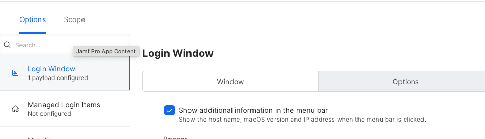

Hi there,
This option was working till macOS Sequoia.
sudo defaults write /Library/Preferences/com.apple.loginwindow AdminHostInfo HostName
This is working with a profile but now with macOS Sequoia it stops working.
Anyone see the same problem and is there a solution?
Thanks

Shyamsundar
  • Oct 29, 2024 1:34 PM UTC
Configure the Login window Option and Select
Show additional information in the menu bar

PE14_2
  • Oct 30, 2024 7:57 AM UTC
@Shyamsundar thanks for input, that settings is what I am using

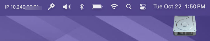

dmccluskey
  • Oct 30, 2024 7:04 PM UTC
IP in menubar is  great app we deploy on all our macs.
Monkeybread Software - Freeware - IP in menubar 4.7.1
We also have a plist they we deploy with it.
<dict> <key>DisplayText</key> <true/> <key>SmallFont</key> <true/> </dict> </plist>
and a start up item payload.
PE14_2
  • Oct 31, 2024 7:29 AM UTC
Thanks for your input, put the option (what is not working) gives not only the IP numer but also computername (sometimes handy here)
  • Apr 1, 2025 10:20 PM UTC
In macOS 15 Sequoia: click and drag from the clock.
PE14_2
  • Apr 2, 2025 7:02 AM UTC
Thanks, it seems to work, but you need to clock to cycle between IPnumber/ComputerName/System version but it works again.
