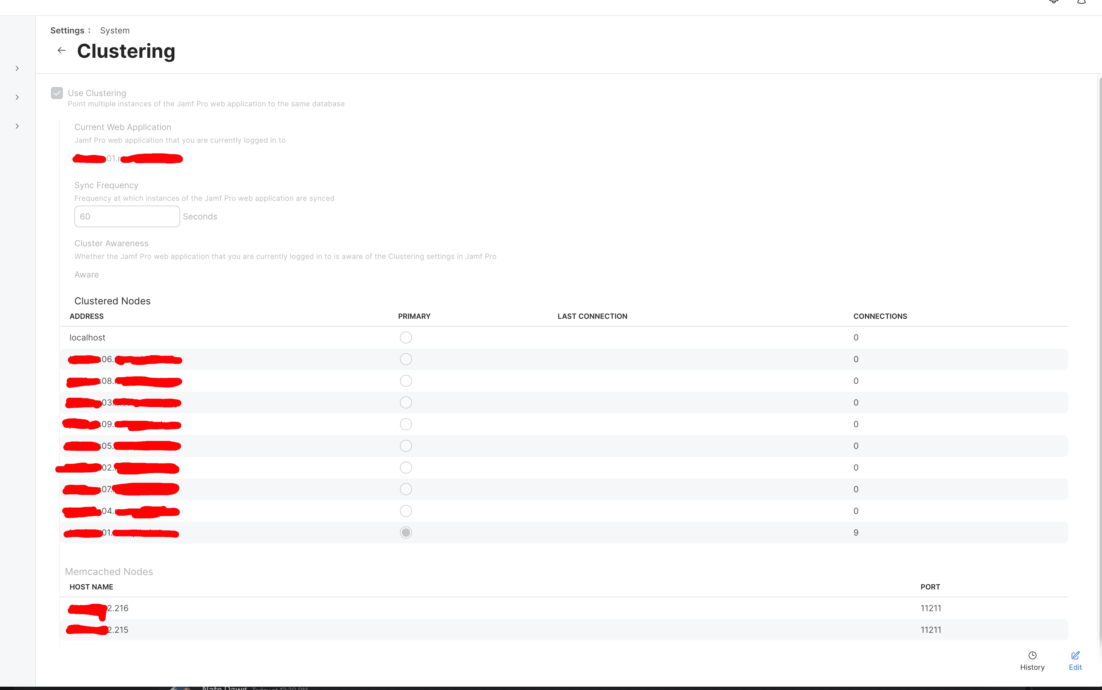

We have a primary node that is used for manipulating the jamf pro GUI and several children nodes behind a load balancer with the GUI disabled. I enabled the GUI and went and looked at the policy on each node and most of them showed an "Unknown" Package. 2 of the Nodes actually showed the package. Interesting, the package exists in the Settings > Packages menu.

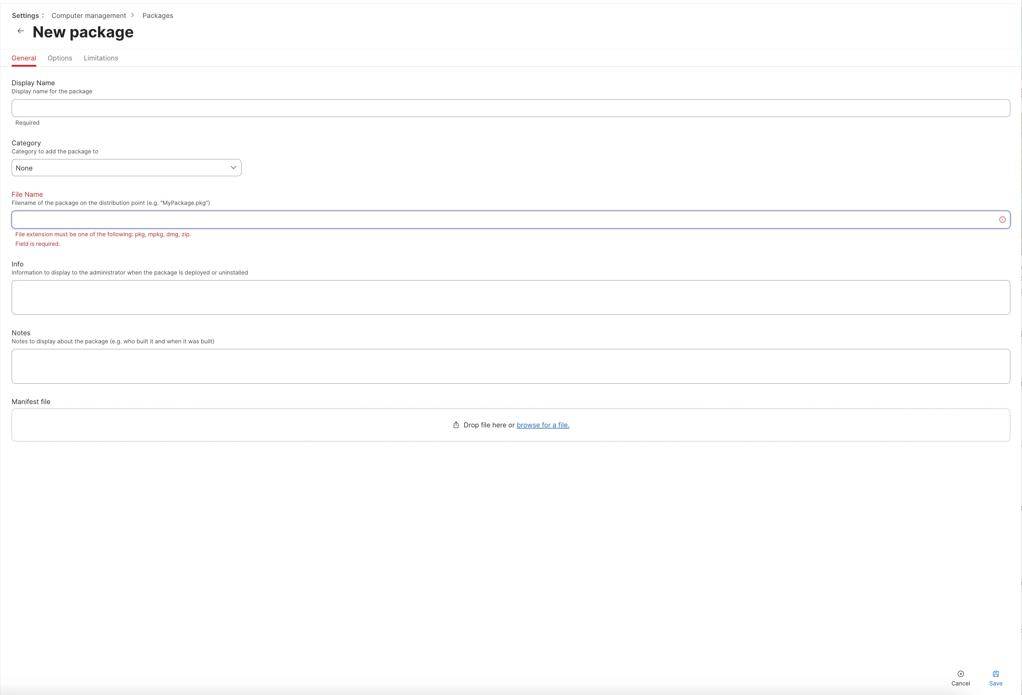

Are you fully on-prem or hybrid? In Settings > Packages I don't have the option to upload a package. I thought this was because we are on-prem only.
In my training classes we could upload using the GUI, but  I thought that was because a Cloud DP was accessible. We don't have a cloud distribution server.
I can manually upload the package to the SMB share and specify the name of the package in Settings > Packages, but in my testing it's been just as inconsistent as using Jamf Sync to do the initial upload and DP sync.

The lack of a cloud distribution point is why you are missing the upload button. Your workflow is correct. I would suggest changing to HTTPS distribution instead of SMB and see if the issue clears up.

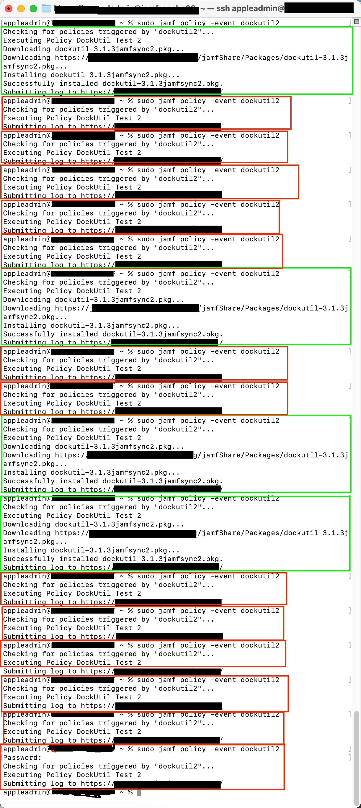

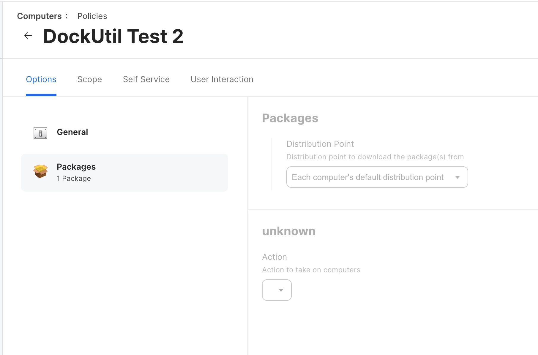

1. Yes we do have a primary Distribution point that we are uploading to first. I've even tried manually uploaded to both distrbution points (without Jamf Sync) to about the same results.
2. No Errors in the Policy. It just completes and doesn't pull any package. I'm guessing it's because over half of the children nodes show an unknown package in the policy.

My guess is the deprecation of Jamf Admin wasn't taken into account for instances without any Jamf Cloud services. Whatever API endpoint that was deprecated in 11.6 probably forced all of the children nodes to sync with each other... othewise... *shrug*.
I do have a jamf support ticket open, otherwise this is a pretty gnarly work around when uploading new packages.
For what it's worth, it doesn't seem to be an issue with overwriting an existing package (upload GoogleChrome.pkg with a newer version with the same file name).
