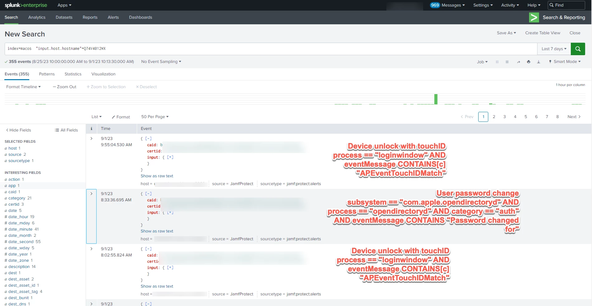

I have telemetry Level 1 already enabled, however I am not seeing data in splunk. I see stuff in splunk from Unified logging, so the traffic is getting across. Any ideas? JAMF Protect is a new endeavor for us, maybe Im missing something.

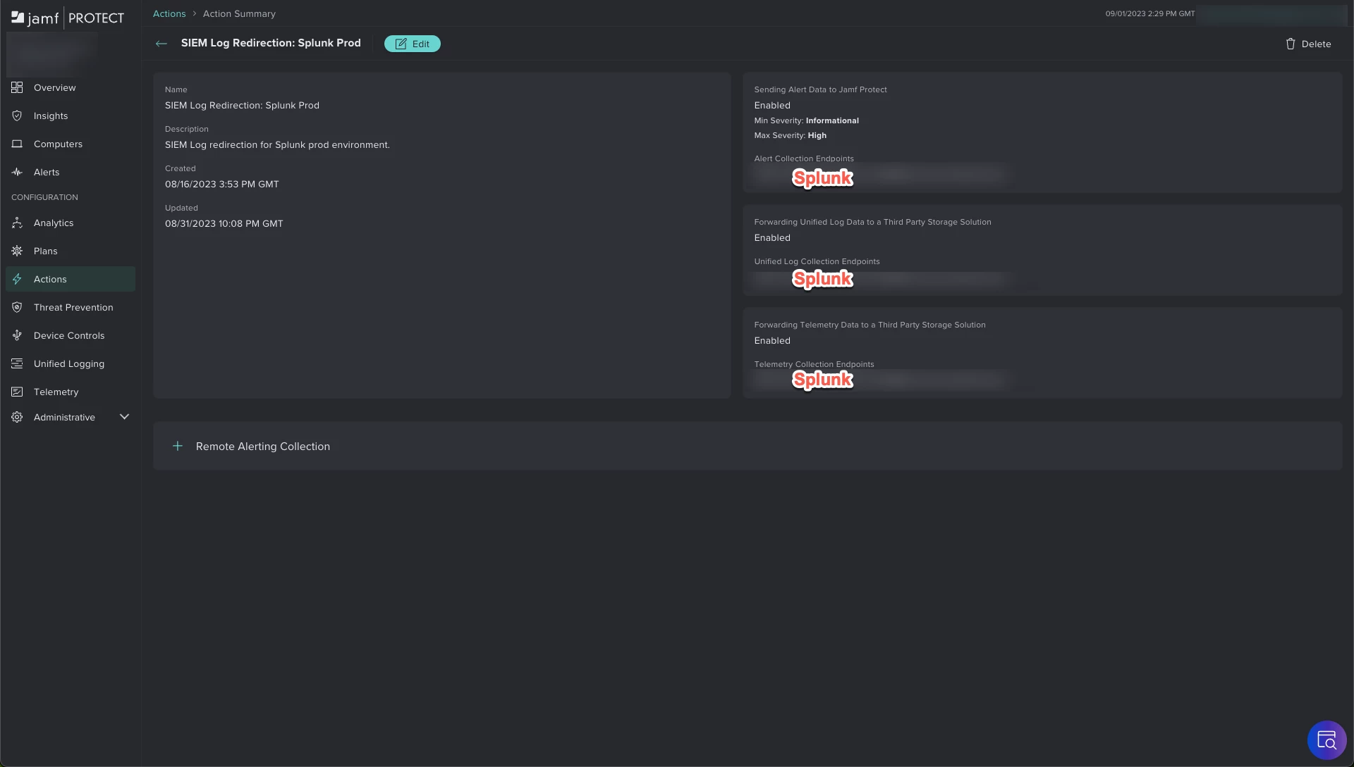

Right - have you created a Telemetry set and assigned that set to a Plan?
If so, make sure to check under actions you have added an HTTP Collection Endpoint for Telemetry as well.

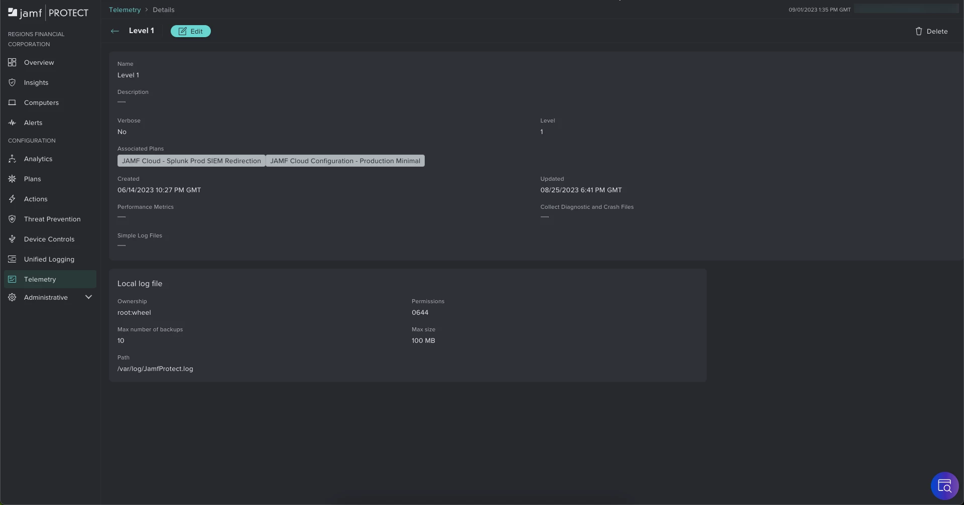

AJPinto
  • Sep 1, 2023 2:35 PM UTC

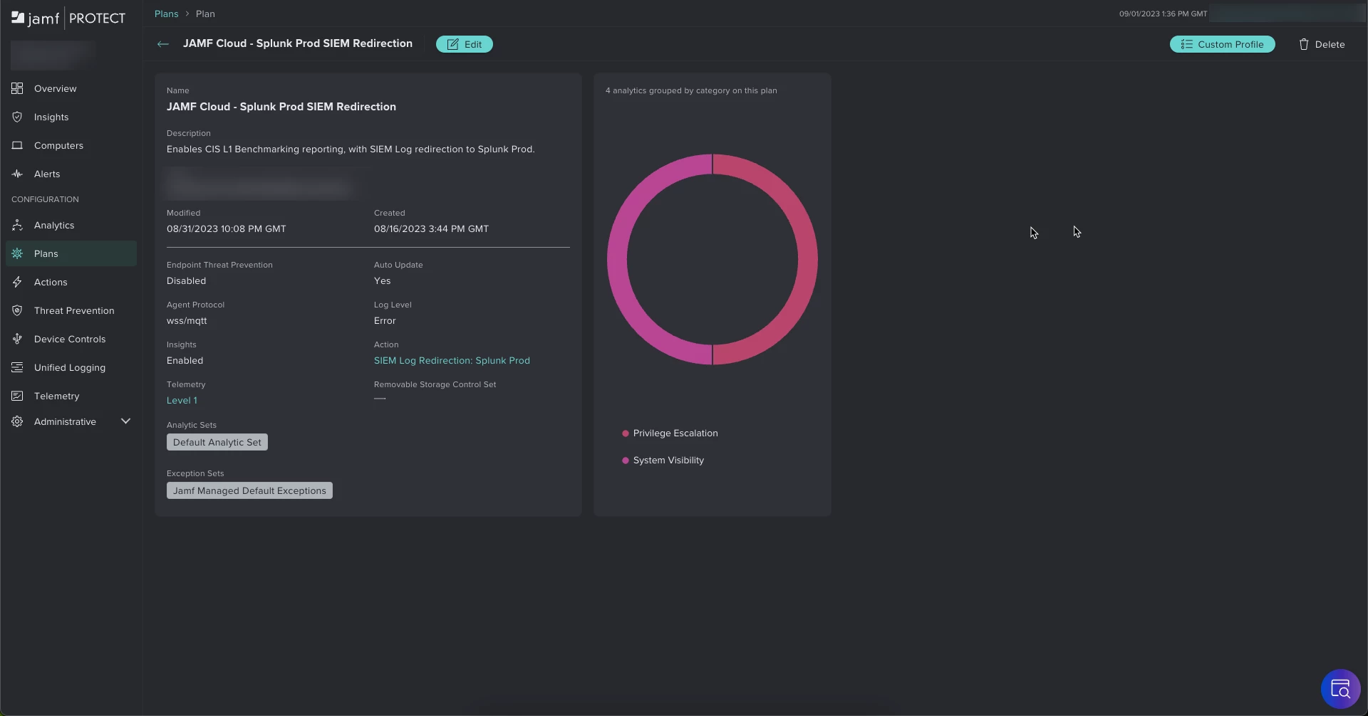

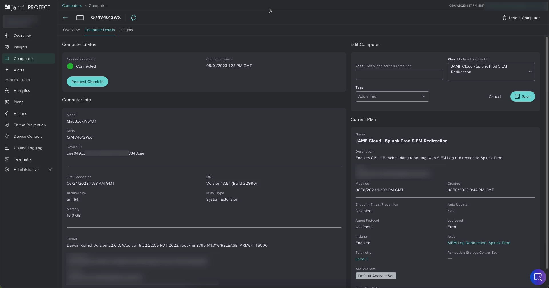

I have Level 1 telemetry configured in the Plan associated with the devices. The Action in the "default plan" has our SIEM (Splunk) configured for Alert Data, Unified Log Data, and Telemetry Data. The devices are showing the correct plan, action, and telemetry log levels.

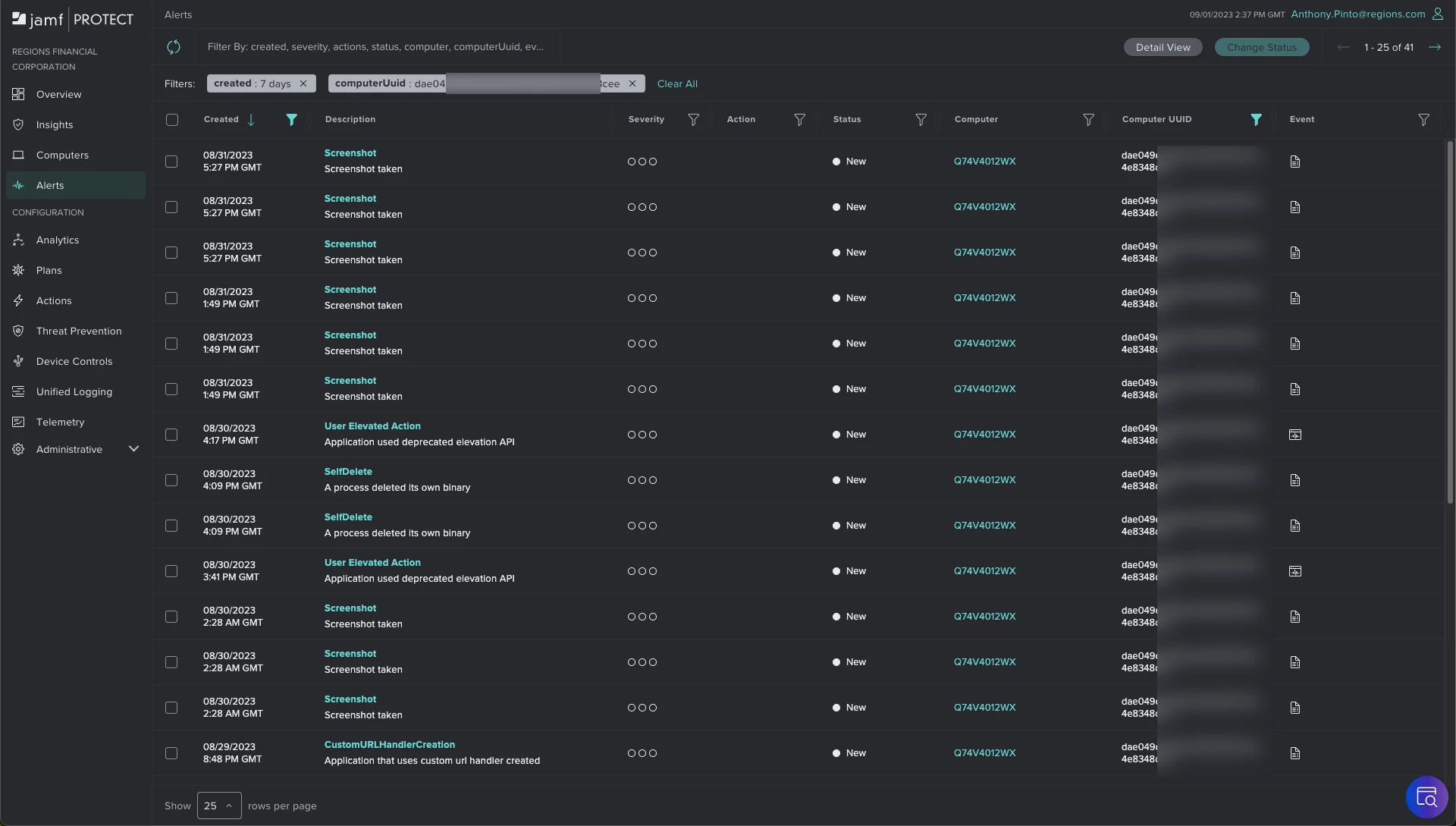

An example of an event I did this morning. I created an account on the device below, I can see the event in the /var/log/protect.log file but I am not seeing the event in Protect or Splunk.

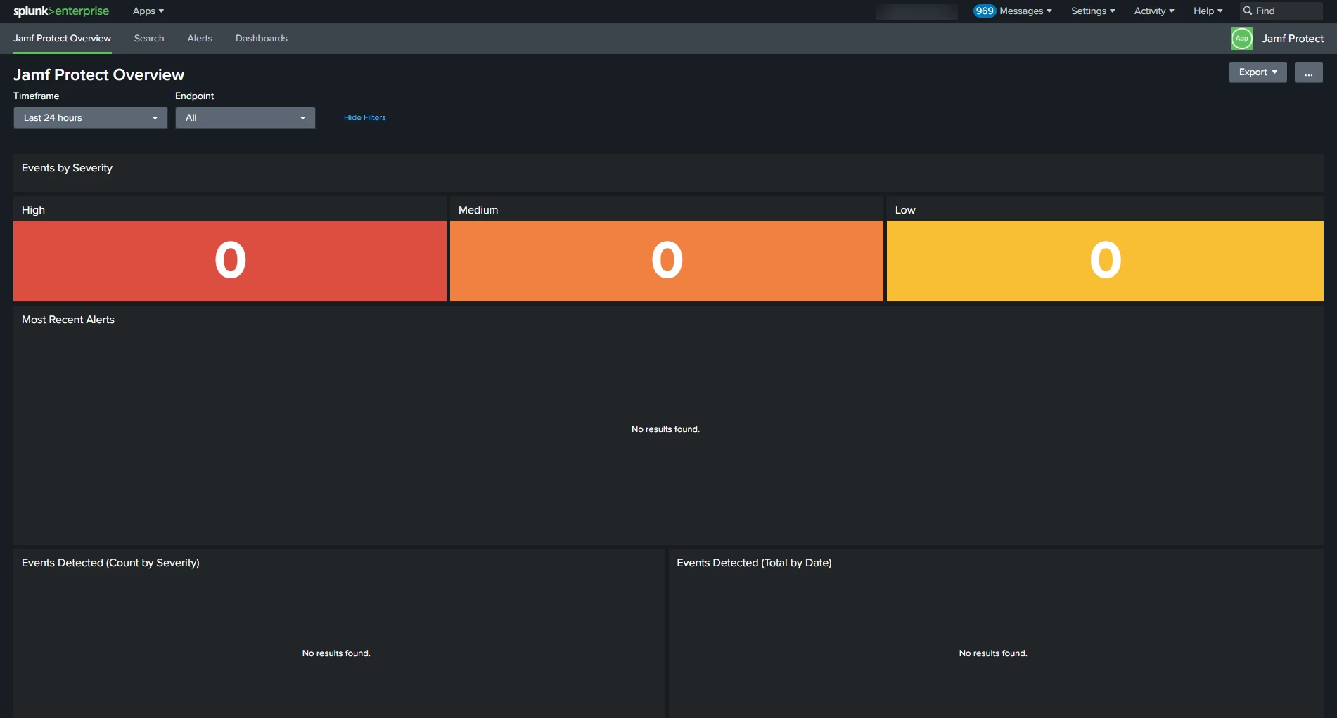

@AJPinto Can you check if you see ANY data from Telemetry in Splunk? ex header.event_name=AUE or a CONTAINS AUE

Also - have you checked out our newly released TA which this week has been updated to version 1.0 https://splunkbase.splunk.com/app/6912
AJPinto
  • Sep 1, 2023 3:22 PM UTC
The Jamf Protect splunk app was installed monday(?) by the splunk team.
I am seeing events, but no where near the volume I would expect. The only events that are populating are from unified logging. I am not seeing anything from telemetry.
