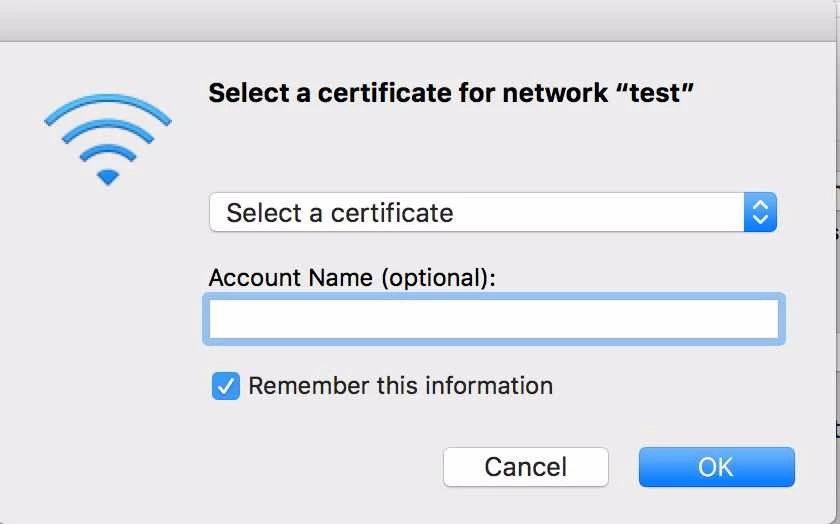

Currently the Macs are requesting the user to choose from two certificates. One is the AD Certificate that has been generated, the other is a jamfcloud cert.

  • February 9, 2018
Tried leaving the username blank and I'm still seeing the same pop up window asking which certificate to use.
@al_platt when you had Mac as the template name, were you seeing the same pop up?
It's frustrating as once you select the correct cert, it does connect but we'd like everything to be automated. I did read the pop up could be due to the CA Root cert not including a subject name but I've checked and the subject is populated with the CA FQDN.

I had to open an Apple Enterprise support ticket after having setup issues as well as we needed the cert to pull down as the machine name for various systems that check for that
Had to update username entry to:
host/%ComputerName%.%AD_DomainNameDNS%
Not sure if that will help you at all
  • February 9, 2018
@sbirdsley I think that's cracked it!!
No prompts and connects straight away.
Thanks so much!

Having the same issue with our ADCS Connector... looking for machine based Certs from ADCS for our EAP-TLS wifi.. I can generate an ADCS certificate and it gets delivered by JAMF Pro to the Machine but then I am forced to choose the certificate to use instead of automatically joining with Machine Cert the first time. I get presented with the com.apple.kerberos.kdc and the Machine ADCS generated certificate. If I select the Machine certificate it gets on and remembers from then on but not sure why it is not using the machine cert in the first place. Any ideas Peeps?

@cjatsbm When you install a device-level profile, the cert goes in to the System keychain. Only connection attempts made the the system will use that connection (com.apple.network.eap.SYSTEM.identity.wlan.ssid.$yourssid). These connection attempts are typically after wake/boot/login. If the user manually selects $yourssid from the menu, it's looking for a com.apple.network.eap.USER.identity.wlan.ssid.$yourssid, if it doesn't have one, it will prompt for the cert then create that identity in the login keychain.
This doesn't explain why it's not connecting automatically after the profile is installed, but should explain the prompt.
One workaround for all this is to also install user-level network profile. All the settings can be the same.
