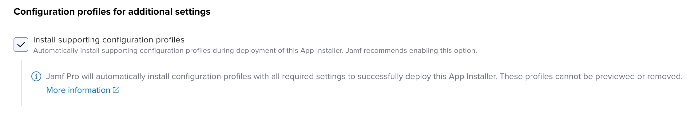

@verticalben that seems 'off'. Out of curiosity, have you enabled the supporting profiles in your App Installers deployments so that the end user are getting notified of the updates?
There is a very, very brief period when the app is closed where App Installers moves the older app to a temp location, puts the new version in the correct place and then (if the new version is installed correctly) the old version is deleted.
This process would normally take one or two seconds, not a minute.
I have seen Edge stop loading web pages on my personal machine (i.e not being managed by App Installers) when it has auto updated and does not start working properly again until I have quit and relaunched it. This could possibly be the same behaviour that you are seeing.
