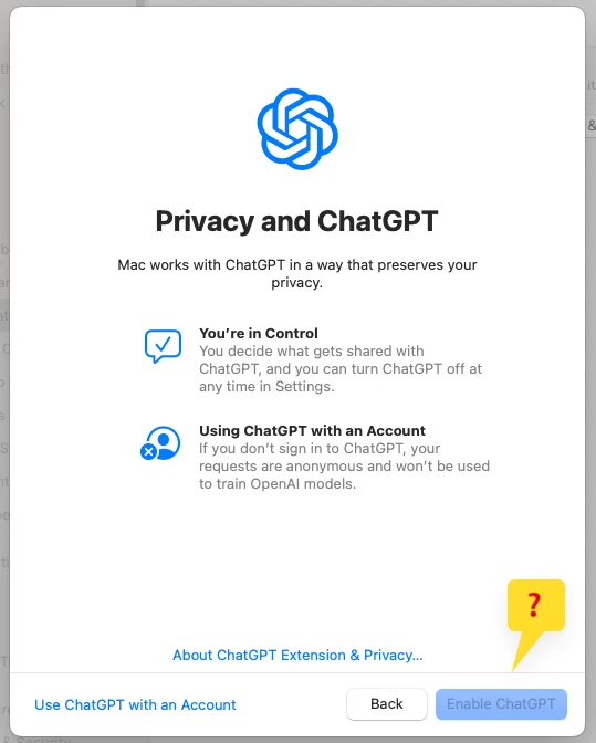

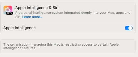

Hey folks,
I'm having trouble allowing users to use ChatGPT. We allow Apple Intelligence on all machines, and so have all the allow buttons ticked in the Restrictions profile, aside from 'Allow integration with external intelligence services (macOS 15.2 or later, supervised)'.

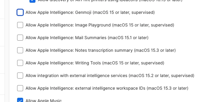

I've removed a few test machines from the scope of the standard config profile, and duplicated the Restrictions Config profile, and then only included a few test machines, and this time allowed integration with external intelligence services (macOS 15.2 or later, supervised). The initial ChatGPT entry is fine:
but I'm seeing a strange blue box that almost looks like you could press it.

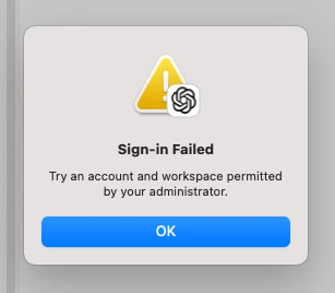

If you try to Use ChatGPT with an account, it doesn't allow that too (last screen shot).
Has anybody else experienced this?

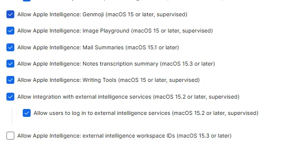

Here are my most recent steps.
If I remove all tickboxes relating to Apple Intelligence
Save, and Distribute to all, my Dock reboots (a sign the machine has downloaded the changes), and I am still signed in to Apple Intelligence.
After a reboot, I am still signed in to AI, and ChatGPT is disabled. After a sudo jamf recon, AI is still signed in. Checking the profile, the tags are set to False:
If I manually turn off AI, I can just manually turn it back on.
If I head back to jamf, and turn back on most the AI stuff:

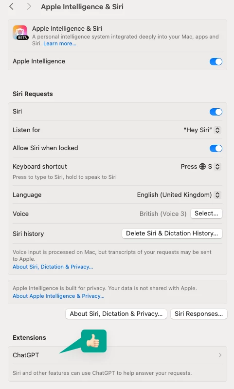

my Dock reboots, the ChatGPT option is then clickable at the bottom of the AI panel, but again, same blued-out box, and I cannot turn on ChatGPT

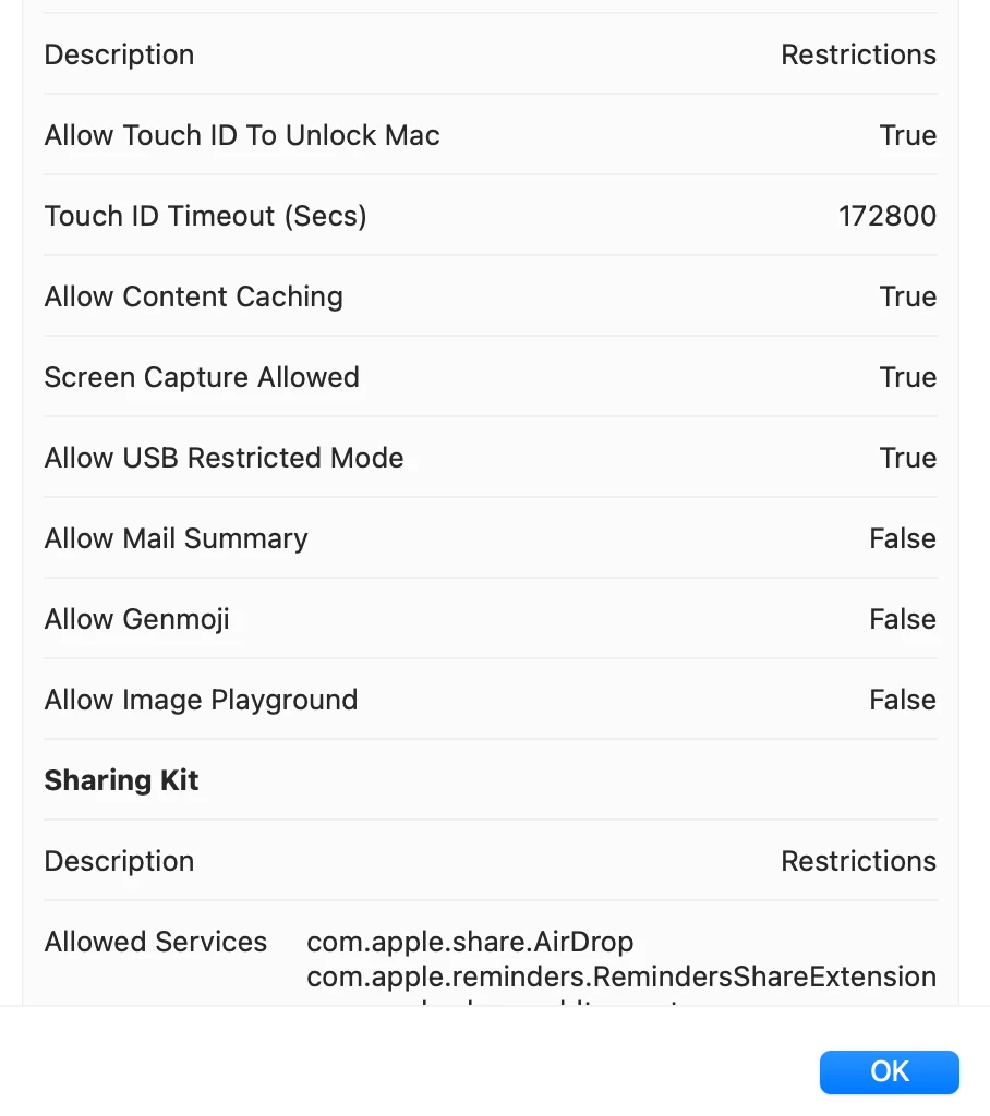

  • May 8, 2025 7:23 PM UTC
Un-checking the options in the Jamf Pro UI will disable those features.
My question is: If you remove the configuration profile related to Apple Intelligence completely does the feature become available? If so, something in your profile is causing this.
I would also recommend using a tool such as iMazing Profile Editor (and signing profiles before uploading) as Jamf Pro has a nasty habit of including other keys when configuring many payloads, including 'Restrictions').
  • May 8, 2025 7:29 PM UTC
Yes if I remove the config profile the blue button then works as normal, it seems a bug with jamf’s config profile because when you try to enable it, it doesn’t work, but does work if you try to disable Apple Intelligence.
  • May 8, 2025 7:41 PM UTC
Recommend you inspect the contents of your profile using System Information on a target Mac to see what's actually getting pushed, or take a look at the profile in System Settings > Device Management.
You're better off using iMazing to create profiles, as I mentioned above.
  • May 8, 2025 7:47 PM UTC
Thanks will do tomorrow, but I did exclude my mac from global config profile, then checked it works, so created as brand new config profile with ONLY the default restrictions and this is what breaks it, should be something so simple but just doesn’t work. :(
  • May 8, 2025 7:51 PM UTC
Feel free to post the text from System Information > Profiles on an affected device here. It's probably something Jamf is pushing that it shouldn't. All of my Apple Intelligence profiles were created outside of Jamf Pro, so I haven't run into this.

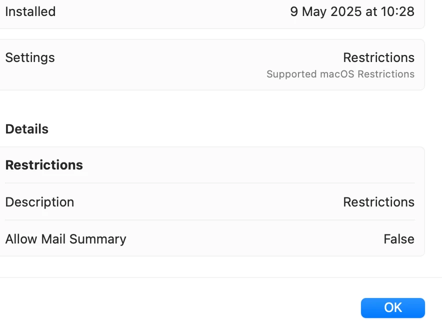

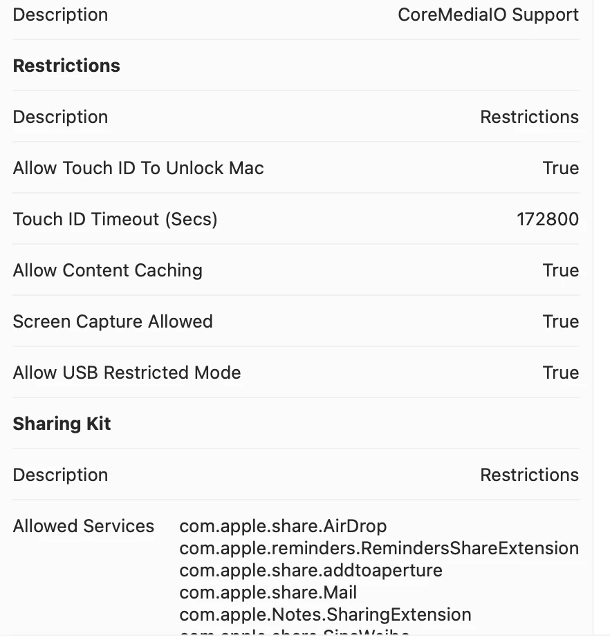

  • May 9, 2025 9:08 AM UTC
Interestingly when checking what's been pushed I don't even see the AI settings when they're enabled, perhaps this is normal, as when I DO restrict them I then see this reflected in settings;
Not sure if that's normal i.e. only disabled/disallowed settings get pushed?
  • May 9, 2025 9:31 AM UTC
so done some testing with imazing, updated the Manifest Repository Update successfully and could see AI under 'other' tab.
Behaves like config profile pushed via Jamf, if allowed no settings are pushed but restrict something and it appears, but still doesn't fix my problem :(

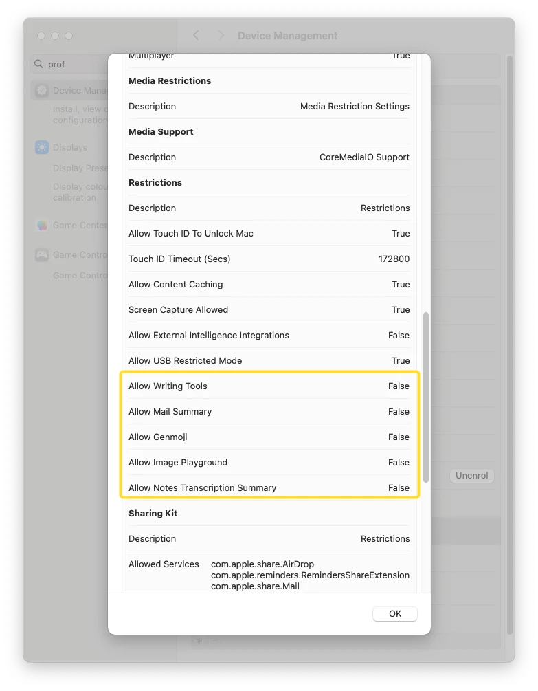

  • May 9, 2025 2:21 PM UTC
I think your issue is caused by the following. Unless you want to restrict Writing Tools, I recommend you remove:
<key>allowWritingTools</key> <true/>
  • May 9, 2025 2:32 PM UTC
If this helps, I just tried unticking Allow Apple Intelligence: Writing Tools (macOS 15 or later, supervised), in jamf and saving the existing profile. My machine updated (dock refreshed), but I can still not use ChatGPT
