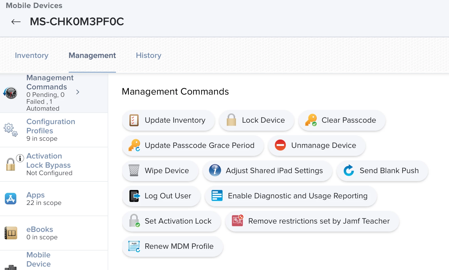

ssagola
Weird thing. All our iPads that updated to 16.2 in JAMF PRO no longer have the ENABLE LOST MODE button in the management tab.

All the devices that do not have ENABLE LOST MODE now show unsupervised in the inventory >security tab
BUT the prestage all have supervise devices.

What seems to be happening, when I wipe a device 16.2 it says "SUPERVISED" but the second I click (Update inventory which fails.) It then says "UNSUPERVISED" rendering a ton of Jamf features inoperable.
I have tried many things myself to get it to go to SUPERVISED but have failed
