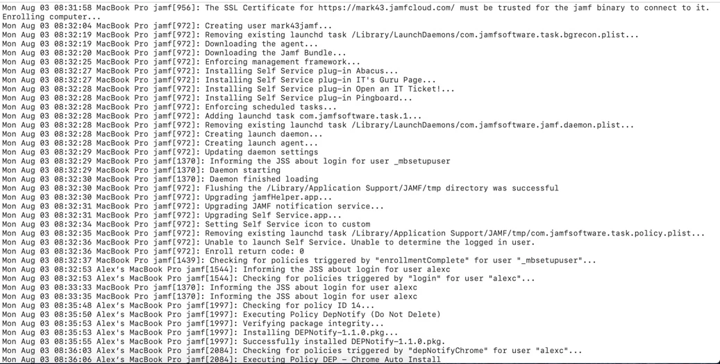

My DEPnotify policy is set to trigger on "Enrollment Complete". It seems as though the trigger only works half the time. I just tried enrolling 3 machines and the policy never ran. I ended up having to run the "DEPnotify (do not delete)" policy manually from Self Service. Any tips? I already tried disabling "Network State Change" Attached is a screenshot of one of the machines.

There are race conditions sometimes with the setup assistant user env to the actual human user env, and I have had to write a ton of code around detecting that. So, I just decided to use a PKG for DEPNotify now with a launch daemon. In fact in your screen shot I see the exact race condition I am talking about. It is trying to run policies as _mbsetupuser and not the actual user

  • September 22, 2020
@gachowski
So the _mbsetupuser doesn't exist in actual user space and is only using during Mac Setup (or Mac Buddy I guess) and you can script around it by pausing your code until the Finder and Dock load. I wrote this heavy boilerplated code, here is the relevant snip

So, even when the system swaps from _mbsetupuser to the first user that got created, there is still a transition period while that user context swaps (as seen in the logs from OP) thus I do an infinite loop until the Finder and Dock are actually running. That seemed to fix my conditions, but I am moving to a launch daemon now.
