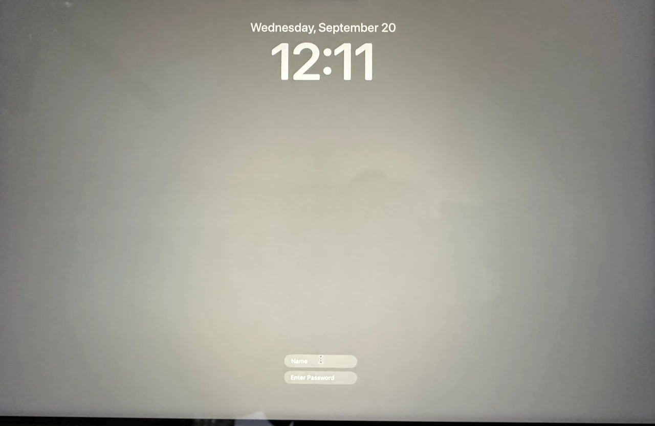

bern
During Enrollment of a Sonoma MacBook, after Remote Management starts and our required Credentials are entered, it Skips creating the Local User Account. It goes straight to a Log-in Screen instead. We do push a hidden Admin Account via Script during Enrollment. I can Log-in with said hidden Admin Account at that new Log-in screen. We only see this issue with macOS 14.x (Sonoma). We can manually Enroll a Sonoma machine without issue. Only during Enrollment of a Sonoma system is it an issue.  For our current Setup, we need the ability to Create Local Users still.  Anyone else see this issue?

  • Sep 21, 2023 8:50 PM UTC
I did have Location Services selected to Skip and allowed Transfer Information set in Enrollment.  This test, I made sure both Location Services and Transfer Information were not suppressed and it still Skipped User Creation, yikes.

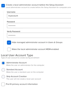

I’ve come up with a solution to the problem and have tested successfully. However, there are some caveats. To make this work, I had to add a payload to the Account section of the Pre-Stage enrollment. I also set the general section to not Skip Location Services. Here is a screenshot of what worked.
However, because the local Admin account created in the Pre-Stage is not automatically LAPS enabled, I have a policy that deletes the account after enrollment. It is scope to any computer with that local account.
Kind of hokey, but it leaves me with a functioning enrollment and the management account from the user-initiated enrollment setting is functional and has LAPS enabled.

Current settings:
  • "Create management account" within Settings > Global > User Initiated Enrollment > macOS unchecked
  • "Create a local administrator account before the Setup Assistant" checked like @John_Arenz mentioned below
Result:
I am forced to provide the credentials for the local administrator account and reset the password. I receive no prompt to create a local user.
Modified settings:
  • "Create management account" within Settings > Global > User Initiated Enrollment > macOS checked
  • "Create a local administrator account before the Setup Assistant" checked in Pre-Stage like @John_Arenz mentioned below
Result:
The local administrator account before the Setup Assistant was created as well as the management account. I was not forced to provide credentials and was prompted to create a computer account.
A different set of settings:
  • "Create a local administrator account before the Setup Assistant" in Pre-Stage unchecked.
Result:
I am forced to provide the credentials for the management account, which has to be pulled from the Jamf API. I receive no prompt to create a local user.
