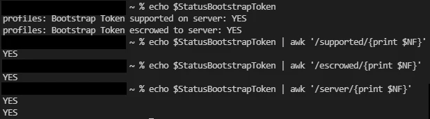

Hey @kyle.erickson, thanks for that extension attribute but after implementing it I noticed a little mistake that needed to be fixed. When the profiles command is run in that script it seems to be interpreted as one line which means that AWK sets both of the "Supported" and "Escrowed" variables to the value of whatever the "Escrowed" variable is supposed to be. This means that it is impossible for "Result" to ever return a value of "Supported" when it is supposed to. I updated your extension attribute script below to use grep instead to fix this issue:
#!/usr/bin/env bash
export PATH=/usr/bin:/bin:/usr/sbin:/sbin:/usr/local/bin
# Checks on if the bootstrap token is supported and escrowed by MDM
# Validating minimum OS version for attribute (10.15.0 or later)
OSVersion=$(sw_vers -productVersion)
OSVersionMajor=$(echo $OSVersion | cut -d '.' -f 1)
OSVersionMinor=$(echo $OSVersion | cut -d '.' -f 2)
if [[ $OSVersionMajor -eq 10 ]] && [[ $OSVersionMinor -lt 15 ]]; then
    echo "<result>Collected for macOS 10.15.0 or later</result>"
StatusBootstrapToken=$(profiles status -type bootstraptoken 2>/dev/null)
if [[ -n $StatusBootstrapToken ]]; then
    Supported='supported on server: YES'
    Escrowed='escrowed to server: YES'
    if [[ "$StatusBootstrapToken" == *"$Supported"* ]] && [[ "$StatusBootstrapToken" == *"$Escrowed"* ]]; then
        Result="Escrowed"
    elif [[ "$StatusBootstrapToken" == *"$Supported"* ]]; then
        Result="Supported"
    else
        Result="Not Supported"
echo "<result>$Result</result>"
  • Jun 10, 2021 4:38 PM UTC

send "$adminPass\\r"
expect eof
This worked!
