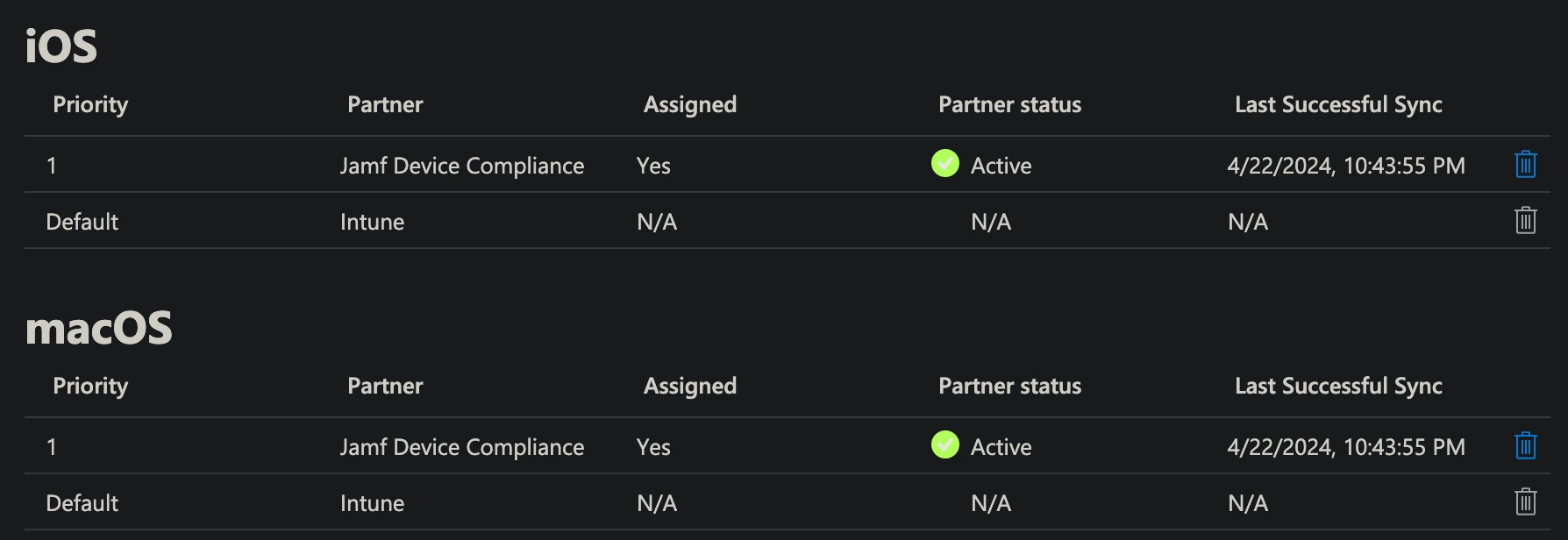

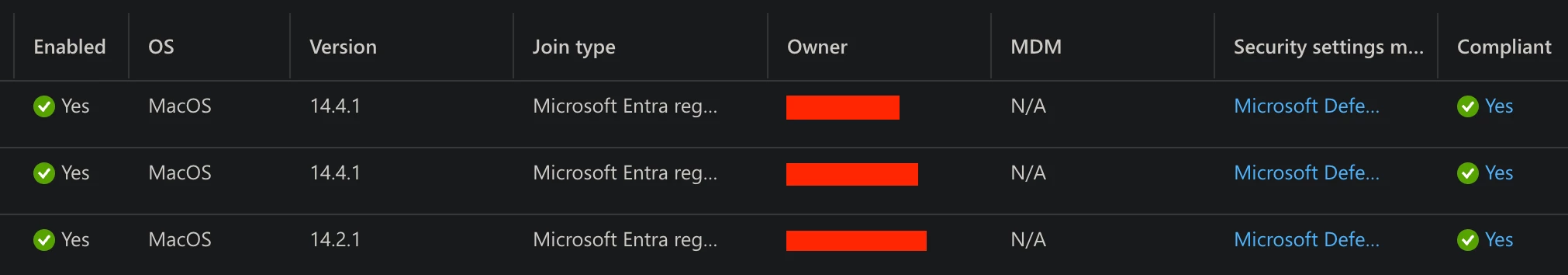

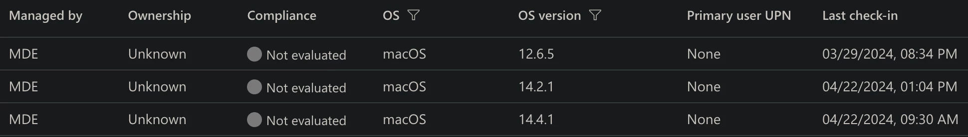

I've setup the "Device Compliance" in Jamf as well as the "Partners Compliance Management" in Entra ID successfully and syncs daily with Jamf. However, it appears that after a macOS device has registered in Entra ID, a day later it's no longer compliant and "MDM" is no longer reporting as "Microsoft Intune" but as "N/A".
In Intune, all macOS devices are also not reporting any compliance status. Any suggestions?

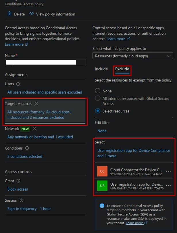

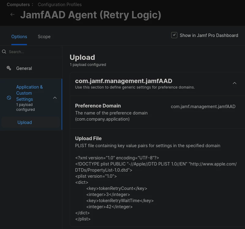

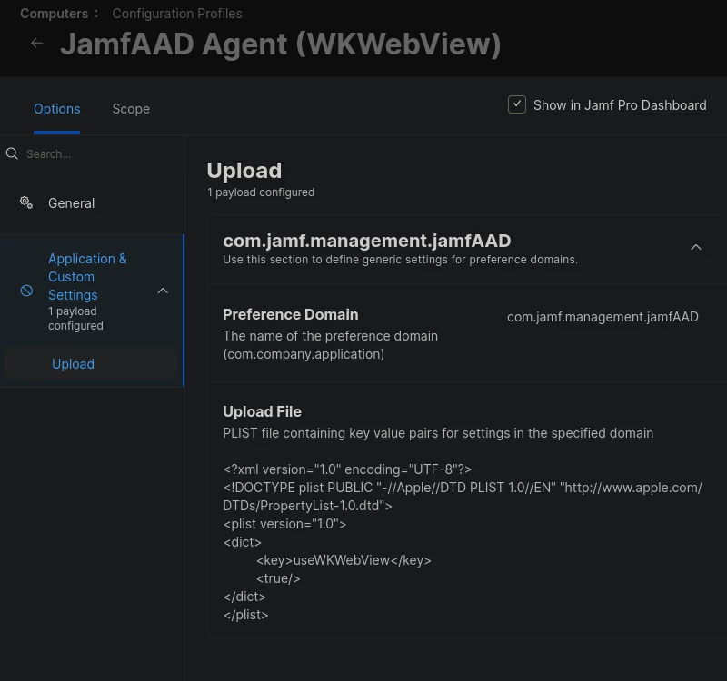

My apologies to the community for the late response. We were able to address the problem (thanks to Julie Flanakin, Jamf Engineer). Here are the steps taken to address the compliance issues for macOS devices:
From Jamf Pro, create two separate configuration profiles for "Retry Logic" and 'WKWebView".
For more info, click here.
Set both configuration profiles use the same Preference Domain:  com.jamf.management.jamfAAD
Set both configuration profiles for  the "General" payload, set to apply at the "Computer Level" and "Install Automatically".
Set the payload for the "Application & Custom Settings" > "Upload" to use the following plist configuration below for "Retry Logic" and 'WKWebView" (see below as well as snapshots)
In Entra ID, set to exclude from Conditional Access Policy the "User registration app for Device Compliance" and the "Cloud Connector for Device Compliance" apps. (see last snapshot below)
Plist for the "Retry Logic" configuration profile:
<plist version="1.0">
<dict>
<key>tokenRetryCount</key>
<integer>3</integer>
<key>tokenRetryWaitTime</key>
<integer>42</integer>
</dict>
</plist>
Plist for the "WKWebView" configuration profile:
<dict>
<key>useWKWebView</key>
<true/>
</dict>
</plist>
