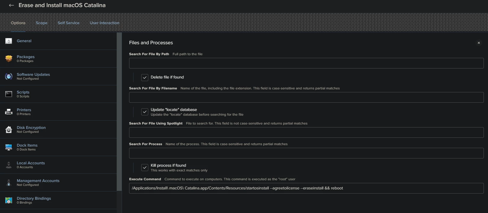

Based on a JAMF webinar I want to create a self serv item that would format the drive on a Mac and install Catalina.
I have created a policy that deploys Install macOS Catalina.app to /Applications
and a second policy that executes the command '/Applications/Install macOS Catalina.app/Contents/Resources/startosinstall' --eraseinstall --agreetolicense --forcequitapps --newvolumename 'Macintosh HD' --nointeraction &
In theory, this should quite all open apps, restart the computer, wipe the drive and install macOS Catalina.
All it does is create a new partition and dump the installer files in there. That's it! The Catalina package runs fine when I install it manually.
What am I doing wrong here?

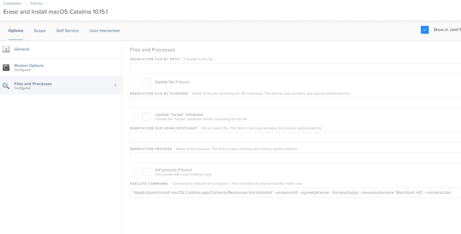

Do you still have issues if you remove the "--nointeraction" ? We use the same command as you except we only use "--nointeraction" for upgrades or when running directly from the command line to suppress the install UI. Not sure it's needed when using "--eraseinstall"

We used to use a method like you are trying to do. However, we moved on to using this. https://github.com/kc9wwh/macOSUpgrade/blob/master/macOSUpgrade.sh
But to answer your question try the following instead... "/Applications/Install macOS Catalina.app/Contents/Resources/startosinstall" --eraseinstall --newvolumename "Macintosh HD" --agreetolicense &

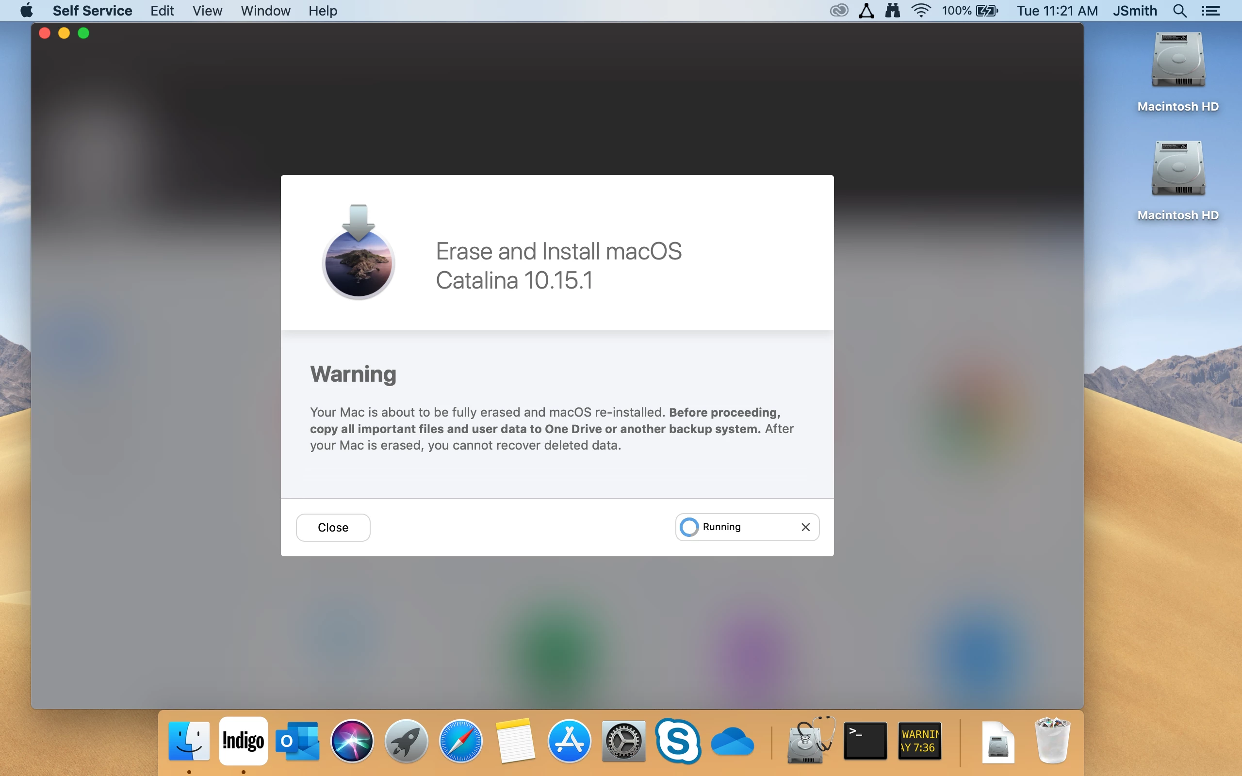

I run the script through a policy that is available in Self Service
Since Apple released 10.15.15 the script needs to be updated to reflect that change
--full-installer-version 10.15.4
to --full-installer-version 10.15.5
I would suggest to only make it available to Macs with sufficient disk space as well and only Macs running Catalina.
