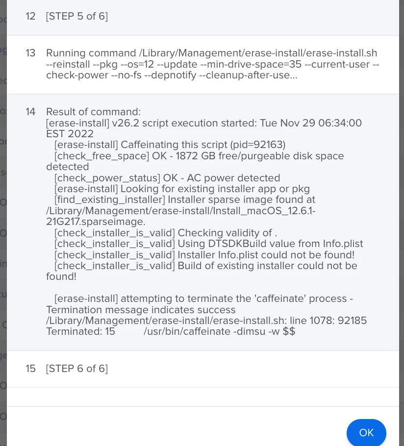

I ran in to an issue while trying to this on an Intel mac. So far this tool works great. I got the below error message and I'm thinking it's maybe because this Mac has 2 partitions, Macintosh HD and Macintosh Data.
sdagley
  • November 23, 2022
@SMR1 That error indicates a problem with the installinstallmacos.py script that erase-install tried to use to build the macOS Monterey installer. Use the --pkg (that's "minus minus pkg" in case it gets reformatted) option (https://github.com/grahampugh/erase-install/wiki/3.-Downloading-(caching)-a-macOS-installer-pkg) which tells erase-install to download an Apple created macOS installer .pkg instead.

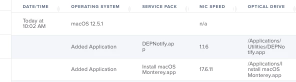

I added the --pkg to the below string I was using. I worked with 2 users on Intel Mac's that got errors before adding the --pkg. On one one of them, it looks like it updated, but the policy isn't showing as complete in the Policy Log. Just waiting for the other user to log back on.
log/Library/Management/erase-install/erase-install.sh --reinstall --pkg --os=12 --update --min-drive-space=35 --current-user --check-power --no-fs --depnotify --cleanup-after-use
sdagley
  • November 29, 2022
@SMR1 That's normal. Since the Mac restarts at the end if startosinstall works then the policy running the erase-install script terminates without technically completing. You'll want the Mac to report inventory at login (or use a LaunchDaemon that runs a script on startup to see if the macOS build version has changed and do a `jamf recon` if so) so the Mac falls out of scope for the update policy

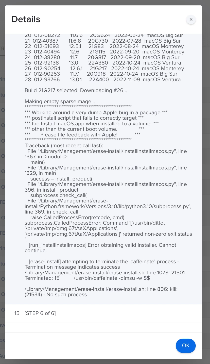

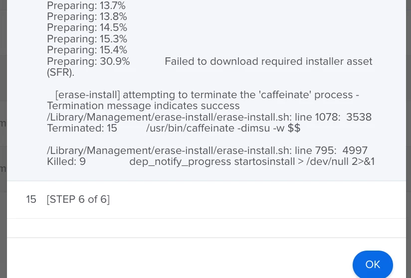

Ok, makes sense. It's weird, I'm seeing different failure issues on some devices. I'm thinking the users aren't letting the script and are restarting, because once the upgrading screen goes away it can take a few minutes to restart and I think they're restarting manually. Would that be the case for these errors?
[run_installinstallmacos] Error obtaining valid installer. Cannot continue.

The 1st of the two errors you posted on Tuesday implies there was a bad version of the installer downloaded. The 2nd error I've seen when the BridgeOS updater can't be downloaded by the macOS installer (you can't pre-download it). Do you use any sort of network traffic inspection/filtering? Those can cause problems with the latter, but why it's only on some systems and not all I couldn't say.
SMR1
  • December 1, 2022
My guess on the second error is they might have been on the VPN, even though I told them do not connect. I'll do some more testing with the --update removed. Thanks

I had a user test again and still getting the 2nd error. The thing is, it's downloading the installer and placing it in Applications. I verified with the user that he can see the Install macOS Monterey under /Applications
sdagley
  • December 5, 2022
@SMR1 It's not the download of the macOS Monterey installer that's likely to be a problem, but the secondary BridgeOS installer that will be downloaded while running the macOS Monterey installer on x86 Macs with the T2 chip. That download will fail if the traffic to the Mac is being SSL inspected and the Apple server providing the download isn't exempted. Apple's KB article on what servers need to be exempted can be found here: https://support.apple.com/en-us/HT210060
