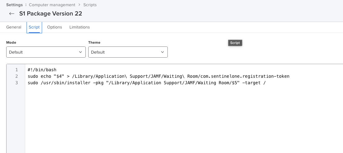

Here is the script I started using from Jamf Nation:

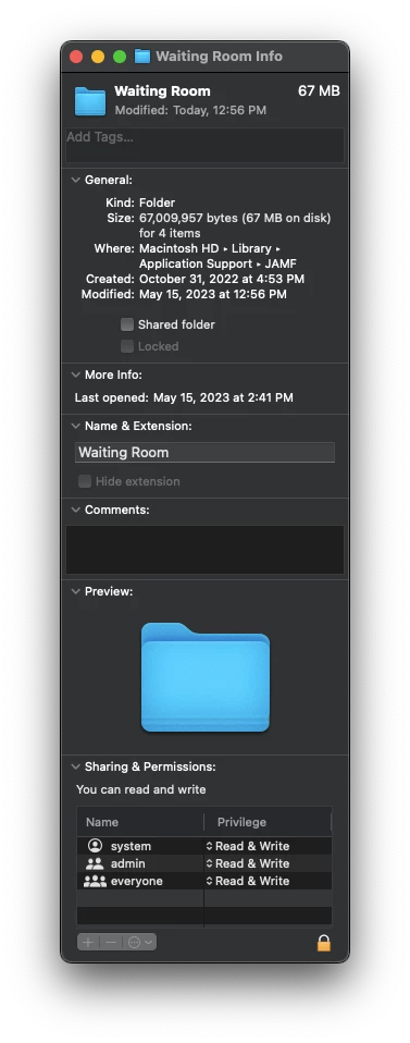

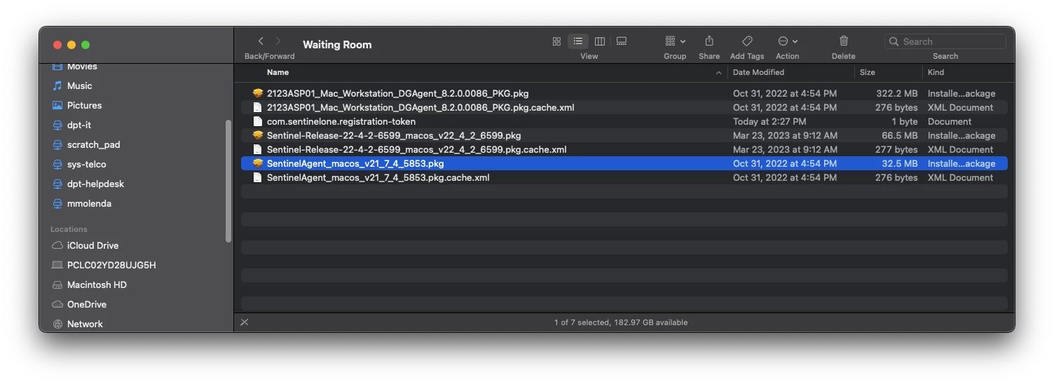

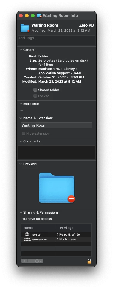

I found the Waiting Room and I had to give myself permission to view the folder because I don’t have access
The agent file is there.  But it fails to install.
Is there anything I should do?  It is failing on all of our organization's Macs.

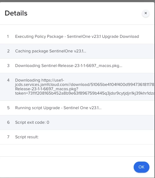

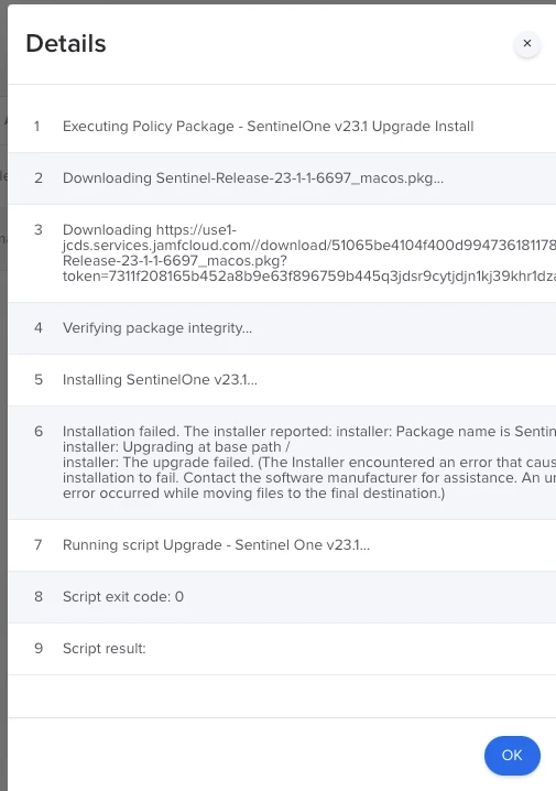

Update: Failed with different error.
Executing Policy Package - S1 Version 22 Upgrade
Downloading Sentinel-Release-22-4-2-6599_macos_v22_4_2_6599.pkg...
Downloading https://use1-jcds.services.jamfcloud.com//download/51065be4104f400d994736181178ca03/Sentinel-Release-22-4-2-6599_macos_v22_4_2_6599.pkg?token=1783f3a4ea4042bfa34cb5af6c8aa3d4x1oote41134qzs9xklqawazcrp1mjg6z...
Verifying package integrity...
Installing SentinelOne v22...
Installation failed. The installer reported: installer: Package name is SentinelOne
installer: Upgrading at base path /
installer: The upgrade failed. (The Installer encountered an error that caused the installation to fail. Contact the software manufacturer for assistance. An unexpected error occurred while moving files to the final destination.)
Running script Upgrade - Sentinel One Version 22...
Script exit code: 1
Script result: Failed to upgrade (did not allow upgrade or downgrade as the version could not be extracted from the package).

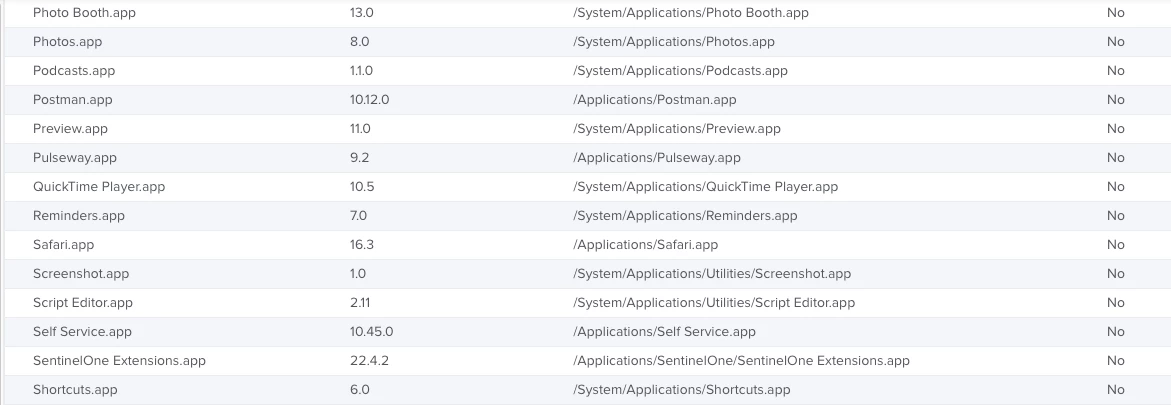

  • May 15, 2023
This just get stranger and stranger.  I wonder if it has to do with Ventura?  On one machine, I changed Waiting Room to be accessible by "everyone" because the error I kept getting was that it couldn't access the file.  I also found issue with my setup that the pkg file was downloading to the Waiting Room directory.  So, on this machine where I have this:
I modified the Waiting Room folder to have admin Read and Write; everyone Read and Write (I know these redundant...)
It says it failed, but I see that it has been installed. Or maybe it's partially installed.  "An unexpected error occurred while moving files to the final destination."  But, it appears to have actually installed.
Shows version 23.1.1.6697 installed.
Running the same script, it completely failed on this user's machine.
I verified that 22.4.2 is still installed.  Actually, this one showed as failed and I thought it wasn't installed.  This is a pleasant surprise, but I am frustrated at the S1 install process.
This is the script that is running.

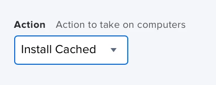

In your install policy are you selecting the action to install the cashed PKG?
  • May 16, 2023
No, I have it set to "Install".  Is that what I should set it to?
Jordy-Thery
  • May 16, 2023
The script you’re using is expecting a cached package so you should set it to cache rather than install. 😊

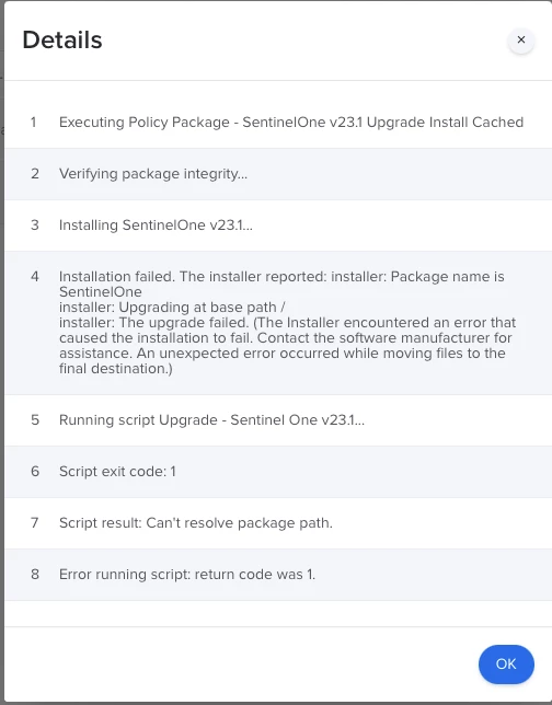

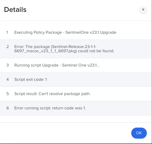

Still it fails, but for different reasons.
This is on all machines that don't have it installed.
This is on mine which does have it installed.

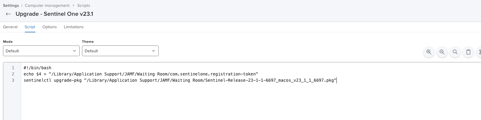

Can't resolve path:
sentinelctl upgrade-pkg "/Library/Application Support/JAMF/Waiting Room/Sentinel-Release-23-1-1-6697_macos_v23_1_1_6697.pkg"
It didn't download the .pkg but in the past, it has.
  • May 16, 2023
This is so frustrating.
If I say "Cache", it downloads the file and that's it.
I had one of my users reboot and the 23.1 version installed.  After the cache and install policies (separated), it needs a re-boot.  I have another user that I am going to do and he will reboot tonight and tomorrow I will see if it worked.
If I say "Install", it fails.
If I say "Install Cache", it fails because the file it downloaded as "Cached" is removed and not re-downloaded.
I have no idea what's going on.  The token file keeps getting re-created.
I had them in Combination.
Policy 1: Cached.  That succeeded.
Policy 2: Install.  Failed.
Policy 3: Install Cached.  Failed due to resolve package path. i.e., the package is no longer there.
