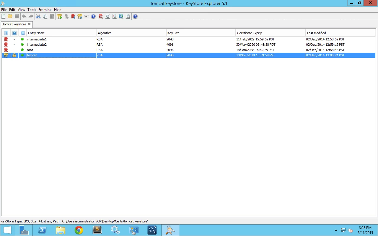

I am a noob to certificates, how do I go about checking the expiration date of my Tomcat certificate?
I checked inside the JSS at https://jss.example.com:8443/tomcat.html?id=0&o=r and see the SSL Certificate expires 11/13/2019, is that the same thing?
Edit: I just opened my tomcat keystore and took a screenshot of the it. It seems to expire in 2019/2020
  • May 19, 2015
Update: I was able to fix my issue. It was indeed my Tomcat keystore that was broken, so I simply backed up my current one, generated a new keystore within the JSS interface and re-installed my SSL certificate.
