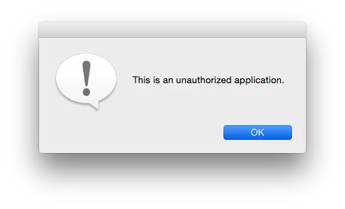

Hello,
After imaging a Mac with Casper I receive this message once I boot the Mac to the desktop.
I can not figure out what is causing this error message to pop up. You can click ok and it will go away for a while but will come right back. Has anyone else here seen this error message before and know what is causing it?

@apanages Do you have any Restricted Software items set up on your JSS? Although that doesn't look like its coming from Restricted Software (the icon isn't what it usually is), it might be from one of them. It looks like jamfHelper to me in the screenshot, so something from your JSS or a function you put together (a policy, Restricted Software, etc) is probably making that appear.

@mm2270 That was it! I looked in the Restricted software section and noticed that someone else added a restrictions with that message. Thank-you!
