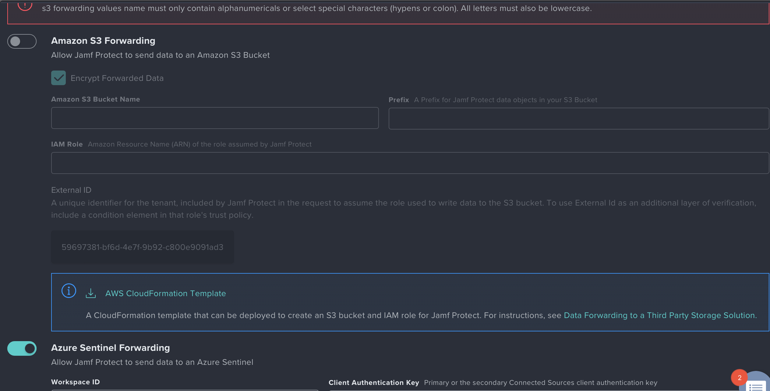

Hi has anyone seen this.
Trying to integrate Azure Sentinel with JAMF Protect and getting an error.
"S3 forwarding values must only contain alphanumerical....."
We are not configuring this and is turned off any ideas?

Fixed this before got a reply but there is a bug in the interface.
To resolve the issue, switch S3 to enabled, provide some dummy data only in the S3 bucket name and switch back to disabled. This should let you submit Azure Sentinel information on the bottom.
