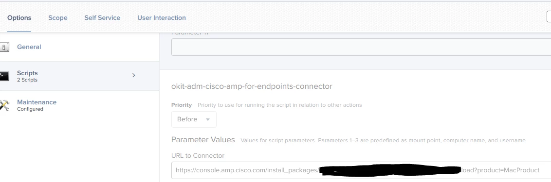

cvangorp
  • September 23, 2021
You shouldn't have to edit the script at all.  Yes @ubcoit script is what I am using.  I would leave $4 in the script this allows you to have separate jamf policies if you have separate amp(now cisco secure) policies (groups) and thus use 1 script in multiple policies just changing the URL.
You paste your URL (from download connector) in the policy in box parameter 4 box see my screenshot.
Did you verify that the url works from the AMP console? Just paste it into a web browser.
Mines still running, no issues or changes that I recall, other than having to update the url from time to time (they expire) which is why I used $4 so I can just update the policy.

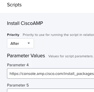

JDaher
Got it!
I think the problem was that while testing this, I first set it up as you both suggested (leaving the script unedited and adding the URL in parameter #4 in Jamf); but then subsequently I edited the script and added the URL there but forgot to delete it from parameter #4 in Jamf. I understand it works both ways but you probably can't have the URL in the script and also in parameter #4 in Jamf.
