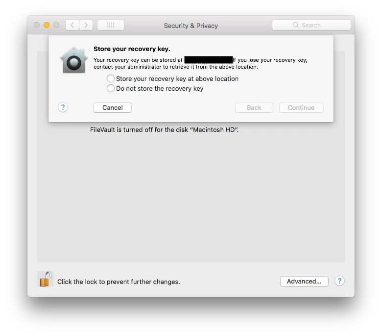

At the company I work for, I.T. sets up all laptops for incoming employees and I'm trying to figure out how to automate as much of the computer setup as possible.
One of the snags I'm running in to is that FileVault 2, when set up from the command line via
sudo fdesetup enable
doesn't provide an obvious way to escrow the recovery key to JAMF like it does when you do FileVault 2 setup manually through System Preferences (see image).
Anyone know how to do this? All the computers this applies to are 10.13 or higher.
Thanks in advance!
