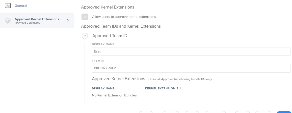

Do you have the ESET kexts and Team ID as Approved Kernel Extensions? These are pushed out using a Configuration Profile and required on 10.13.6 or later.
  • October 17, 2018
Yeah i have that set up. Unless you spot something wrong @Look
  • October 19, 2018
You need the actual KEXT Bundles in there, try adding the following in the lower part.
com.eset.kext.esets-kac
com.eset.kext.esets-mac
com.eset.kext.esets-pfw
com.eset.kext.esets_kac
  • October 19, 2018
thanks @Look
