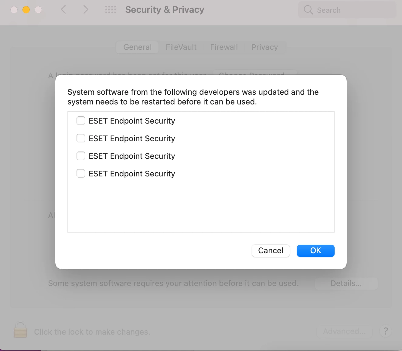

Hello,
Indeed I try to limit as much as possible the interaction of the users for the configuration of the antivirus, only by following the following procedure:
https://support.eset.com/en/kb7324-deploy-eset-endpoint-products-for-macos-using-jamf-pro
I must allI always have to approve manually the extension systems in spite of the plist (see the attached picture)
Do you have a solution to automate this?
Thanks
Duarte
  • August 12, 2021
We have the same issue. Set up policy as per Eset, but user still needs to approve the extensions..
  • December 6, 2021
You can refer to the official documentation and use system extension +PPPC to complete your requirements。
https://support.eset.com/en/kb7718-install-eset-endpoint-for-mac-version-610-remotely-on-macos-big-sur-11
