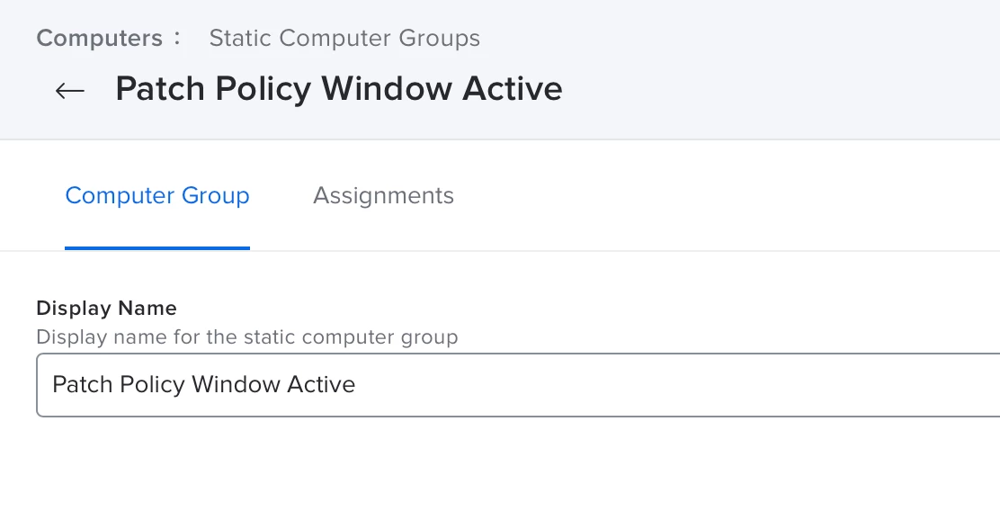

  1. Create a static group as a holding space for the computers that are in a maintenance window. I simply named mine "Patch Policy Window Active."
    • We will need both the name of this group, and it's ID (which of course can be found in the URL for the smart group).

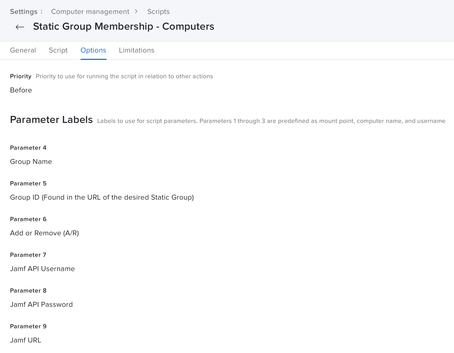

  2. Next, I modified another, pre-existing script tp add computers to, and remove computers from a specified static group.
#!/bin/sh ########################################################################################## # # Static Group Membership - Computers # Originally: Add Computer to Static Group # # This script uses the Jamf Pro API to get a Bearer Authentication Token and then adds a computer to a Static Group. # In this case it could be the computer the script is run on if you uncomment the particular line. I actually set the computer name for testing to a specific name # Adapted from https://derflounder.wordpress.com/2022/01/05/updated-script-for-obtaining-checking-and-renewing-bearer-tokens-for-the-classic-and-jamf-pro-apis/ # (not all functions in Rich's example are used as this is a very short access to the API) # Also help from Steve Dagley in https://community.jamf.com/t5/jamf-pro/bearer-token-api-and-adding-computer-to-static-group/td-p/261269 # and https://community.jamf.com/t5/jamf-pro/script-to-add-computer-to-static-group/m-p/198738 # 2022-03-17 David London # # Modified for UNT by KClose # Added parameter calls for Jamf Options. # Updated static information to match UNT requirements. # # Updated 2023-09-27: Added a remove option as well and updated Parameters. # ########################################################################################## ### VARIABLES ### # Get the Static Group Name *REQUIRED* [ -z "$4" ] && { echo "Static Group Name is required. Exiting."; exit 1; } || { GroupName=$4; } # Get the Static Group ID *REQUIRED* [ -z "$5" ] && { echo "Static Group ID is required. Exiting."; exit 1; } || { GroupID=$5; } # Get Add/Remove. *REQUIRED* if [[ $6 == [Aa] ]]; then changeCommand="Add" elif [[ $6 == [Rr] ]]; then changeCommand="Remove" else echo "Change Command (A/R) is required. Exiting." exit 1 fi # Get the API Username. *REQUIRED* [ -z "$7" ] && { echo "API Username is required. Exiting."; exit 1; } || { jamfpro_user=$7; } # Get the API Password. *REQUIRED* [ -z "$8" ] && { echo "API Password is required. Exiting."; exit 1; } || { jamfpro_password=$8; } # Get the Jamf URL. *REQUIRED* [ -z "$9" ] && { echo "Jamf URL is required. Exiting."; exit 1; } || { jamfpro_url=$9; } # Remove the trailing slash from the Jamf Pro URL if needed. jamfpro_url=${jamfpro_url%%/} # Find/Set the computer name. ComputerName=$(/usr/sbin/scutil --get ComputerName) # Explicitly set initial value for the api_token variable to null: api_token="" # Explicitly set initial value for the token_expiration variable to null: token_expiration="" ### FUNCTIONS ### GetJamfProAPIToken() { # This function uses Basic Authentication to get a new bearer token for API authentication. # Use user account's username and password credentials with Basic Authorization to request a bearer token. if [[ $(/usr/bin/sw_vers -productVersion | awk -F . '{print $1}') -lt 12 ]]; then api_token=$(/usr/bin/curl -X POST --silent -u "${jamfpro_user}:${jamfpro_password}" "${jamfpro_url}/api/v1/auth/token" | python -c 'import sys, json; print json.load(sys.stdin)["token"]') else api_token=$(/usr/bin/curl -X POST --silent -u "${jamfpro_user}:${jamfpro_password}" "${jamfpro_url}/api/v1/auth/token" | plutil -extract token raw -) fi } APITokenValidCheck() { # Verify that API authentication is using a valid token by running an API command # which displays the authorization details associated with the current API user. # The API call will only return the HTTP status code. api_authentication_check=$(/usr/bin/curl --write-out %{http_code} --silent --output /dev/null "${jamfpro_url}/api/v1/auth" --request GET --header "Authorization: Bearer ${api_token}") } InvalidateToken() { # Verify that API authentication is using a valid token by running an API command # which displays the authorization details associated with the current API user. # The API call will only return the HTTP status code. APITokenValidCheck # If the api_authentication_check has a value of 200, that means that the current # bearer token is valid and can be used to authenticate an API call. if [[ ${api_authentication_check} == 200 ]]; then # If the current bearer token is valid, an API call is sent to invalidate the token. authToken=$(/usr/bin/curl "${jamfpro_url}/api/v1/auth/invalidate-token" --silent --header "Authorization: Bearer ${api_token}" -X POST) # Explicitly set value for the api_token variable to null. api_token="" fi } ### MAIN SCRIPT ### GetJamfProAPIToken apiURL="JSSResource/computergroups/id/${GroupID}" if [[ $changeCommand == "Add" ]]; then echo "Adding computer to $GroupName." apiData="<computer_group><id>${GroupID}</id><name>${GroupName}</name><computer_additions><computer><name>$ComputerName</name></computer></computer_additions></computer_group>" elif [[ "$changeCommand" == "Remove" ]]; then echo "Removing computer from $GroupName." apiData="<computer_group><id>${GroupID}</id><name>${GroupName}</name><computer_deletions><computer><name>$ComputerName</name></computer></computer_deletions></computer_group>" else echo "Something went wrong - we shouldn't see this error." exit 1 fi curl -s \\ --header "Authorization: Bearer ${api_token}" --header "Content-Type: text/xml" \\ --url "${jamfpro_url}/${apiURL}" \\ --data "${apiData}" \\ --request PUT > /dev/null InvalidateToken exit 0
  • This script does come with the following parameters defined:

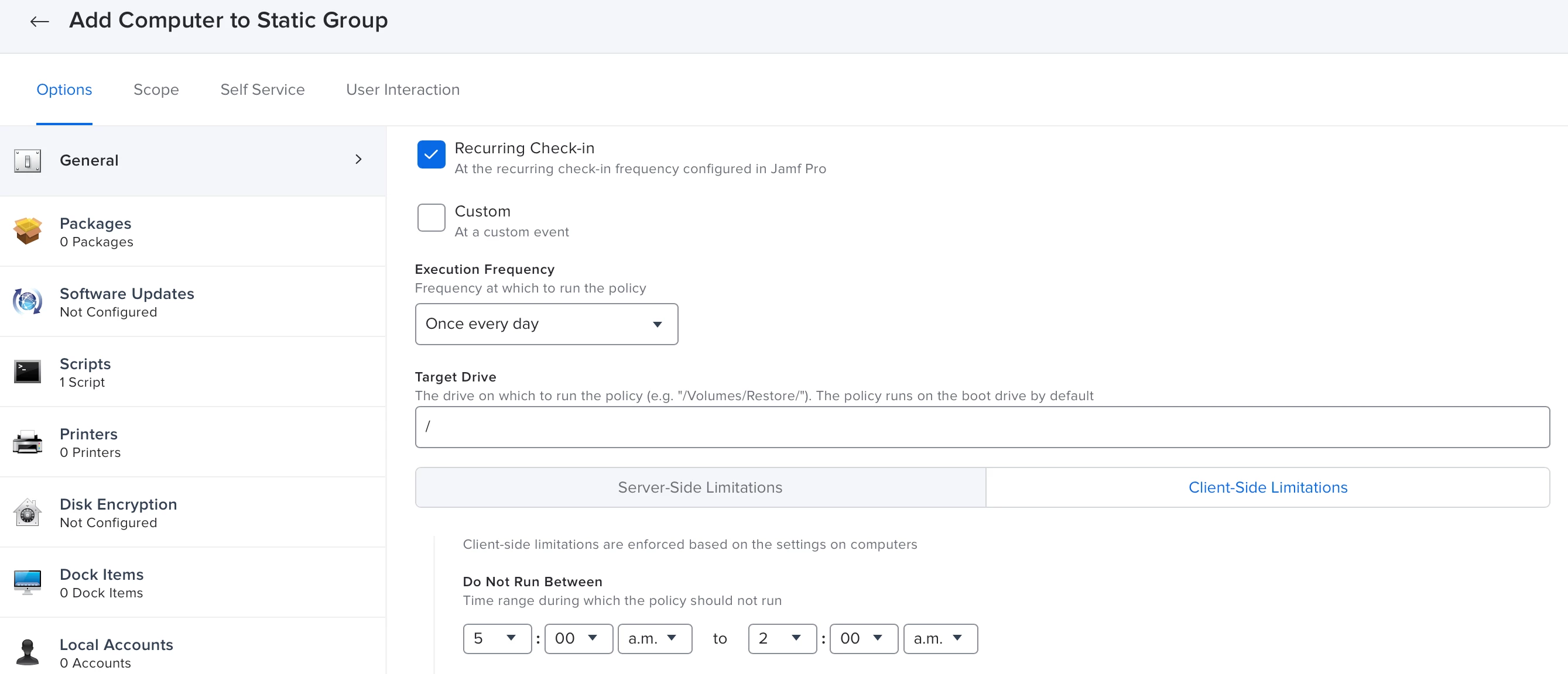

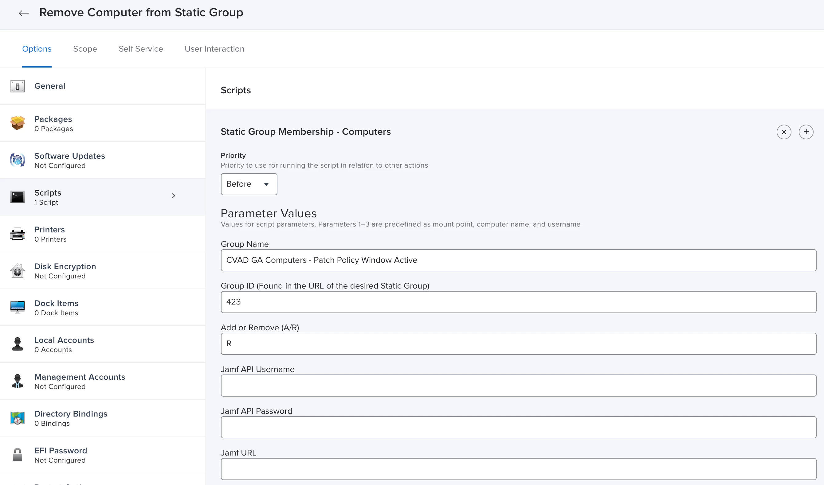

  • The next step is to create a pair of standard policies that will add our computers to the static group, and then remove them from the group at a later time.
    • The main thing here is that we are going to use the Client-Side Limitations to restrict when a computer is added to or removed from the static group.
    • This is also where we will need the static group name and ID.
    • Add Computer to Static Group:
    • Remove Computer from Static Group:
    • Note that in my configuration, the Client-Side Limitations only allow the computers to be added to the group between 2am and 5am, and removed between 5am and 6am.

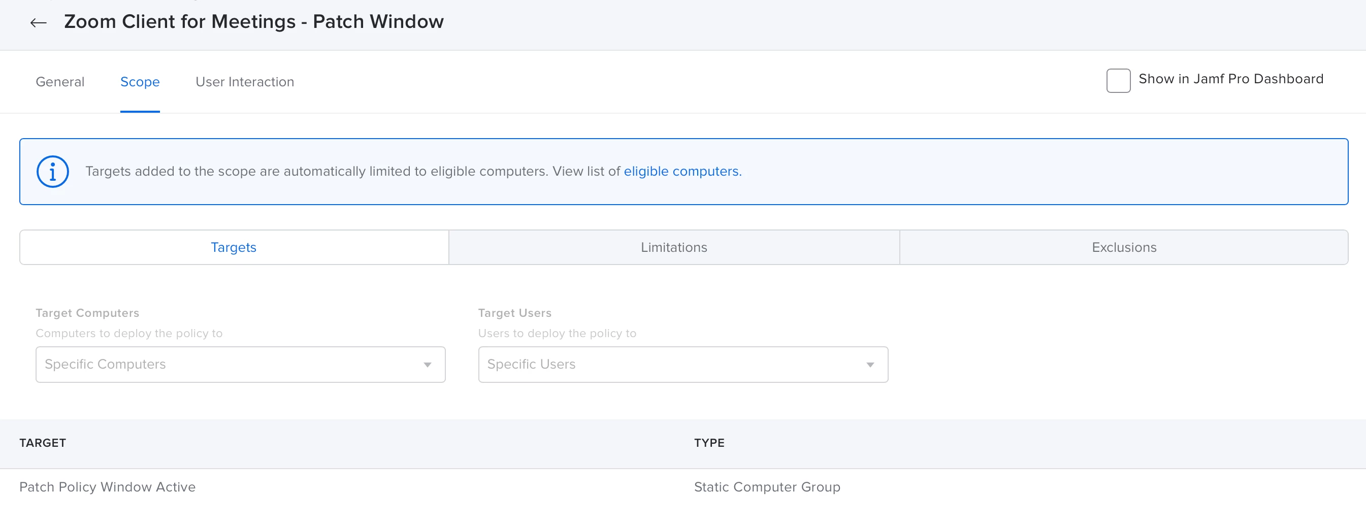

  •  Next we can just create our patch policy and set the static group to be the scope. This way the only computers that are eligible for the patch policy are those that are in the static group that is managed by our patch window policies above.
