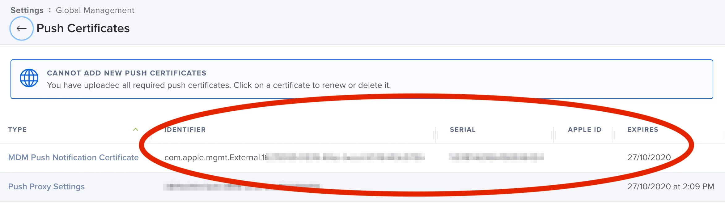

Agree with Ben - rgreenjr724, well worth contacting Jamf Support to see what magic they can do. I encountered the same problem with a customer earlier this week - a lost Apple ID for Apples APNS portal. Hayden @ Jamf Support was super helpful with insight and guidance.
In my scenario, there were only a small number of macOS device and no iOS devices; we could have remote connected and undertaken a manual re-enrol for each device but would have been very disruptive for end users due to the number of policies in play. In the end, Apple Support were able to move the APNs portal access (from lost Apple ID) to another corporate Apple ID in about 3 hours. Amazing experience compared to the process 3 years ago (the last time I had to do one of these "11th-hour-crisis").
For anyone else who might stumble across this discussion, and is looking for possible answers with with Apple IDs and APNs:
Apple Support is here : https://support.apple.com/en-us/HT208643
Apple Support will require the current MDM certificate Identifier and Serial number. Please see below example
!optional image ALT text](![
