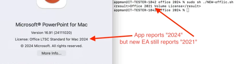

  • Nov 21, 2024 9:19 PM UTC
@tcandela @JasonEgg Could you please test this updated Extension Attribute for Office License and let me know if it helps - Github
@RobbEFX Thanks for your suggestion.
Cursory testing reveals it is only accurate for new deployments, that is, fresh installations without a previously existing license file. For instances where license was "updated" from 2021 to 2024, the EA still reports 2021 even after 2024 license is applied. I believe this is is the "stacked" scenario that @RobbEFX is referring to.
The old pbowden script seemed to identify "stacked" instances by the length of the plist file, but perhaps this is no longer accurate?
I'm going to do some more testing

@JasonEgg Thanks for your feedback, To Summarise the script works as expected on newly deployed device but does not work on existing office which got upgraded from Office 2021 to Office 2024. let me read the entire script and stacked logic to enhance the script. Thanks for the feedback and i believe together we can do it :)

Unfortunately no progress: the new version of the EA will identify only fresh installs of 2024, not the "stacked" instances. I've stared at the license plist files of about 5 devices and can't find a consistent rule to correctly identify 2024 in all cases.
