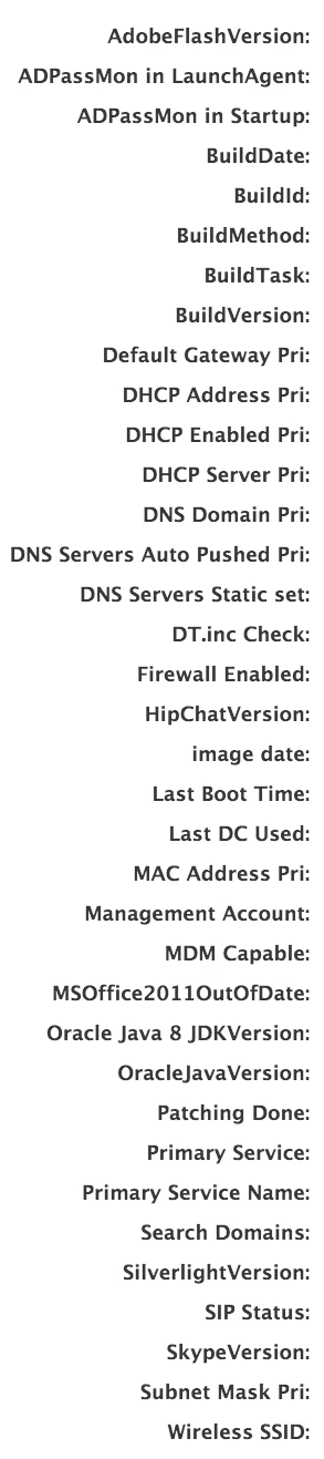

I use EA's for a lot of items. I've got over 20. For importing data into our SCCM instance i had to pull a lot of custom data in order for it to report properly. Below you will see a quick list of some that I use. Some of these were created when using AutoPkgr for patching.
