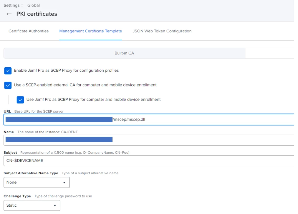

Below is our current configuration as we are trying to use our External CA to provide Computer and Mobile Device Enrollment. However when the certificate shows on the device, it shows as $COMPUTERNAME. I changed this to $DEVICENAME and get the same result. Additionally, when we remove the subject completely from the External CA configuration, it causes the enrollment to fail with the error "Your profile has expired".
As shown we also have SCEP setup for our config profiles and the Subject config is working fine there. Any thoughts are greatly appreciated.
This is on Ventura OS

I don't think the certificate PKI section supports the Configuration Profile variables like $COMPUTERNAME
  • Aug 23, 2023 5:43 PM UTC
I went ahead and set this Subject name to Jamf Enrollment so I atleast know what the cert is for. Thanks Mc, for the info.
