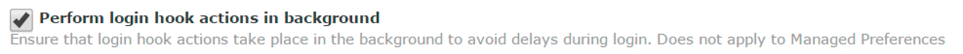

What we also have configured, are login hooks. For the Macs in question we did not run any login policies per se, but when I turned on to run the login hooks in background the issue was gone on one machine (see screenshot below). Now we need to test it if it solved the problem on a larger scale.
The login hook is the standard one from jamf at:
/Library/Application Support/JAMF/ManagementFrameworkScripts/loginhook.sh

bentoms, this is actually what I was working on during the last hours. Only two of our policies are triggered during login and not for the machines in question. Yes, we also have a JSS reachable from the cloud.

Ah ha! Makes sense. Good find @roland.huber!
Please mark the above as the answer for future searchers. :)
  • November 6, 2015
Verified with users and it is solved
