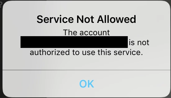

It's kinda confusing for me. If I am using my managed Apple ID, FaceTime works.
If I am using the managed Apple ID of one of our Staff Members, I get the errormessage you can see below.
I have no idea where I can change this.

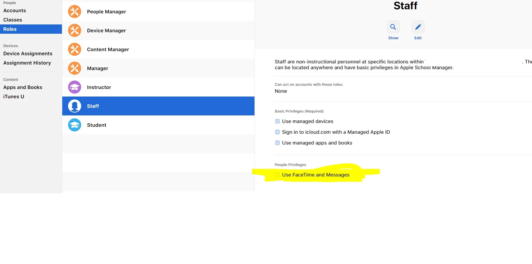

  • July 25, 2019
Actually there is an option to enable in the Settings on ASM.
settings>accounts
You should have the same option in ABM too...

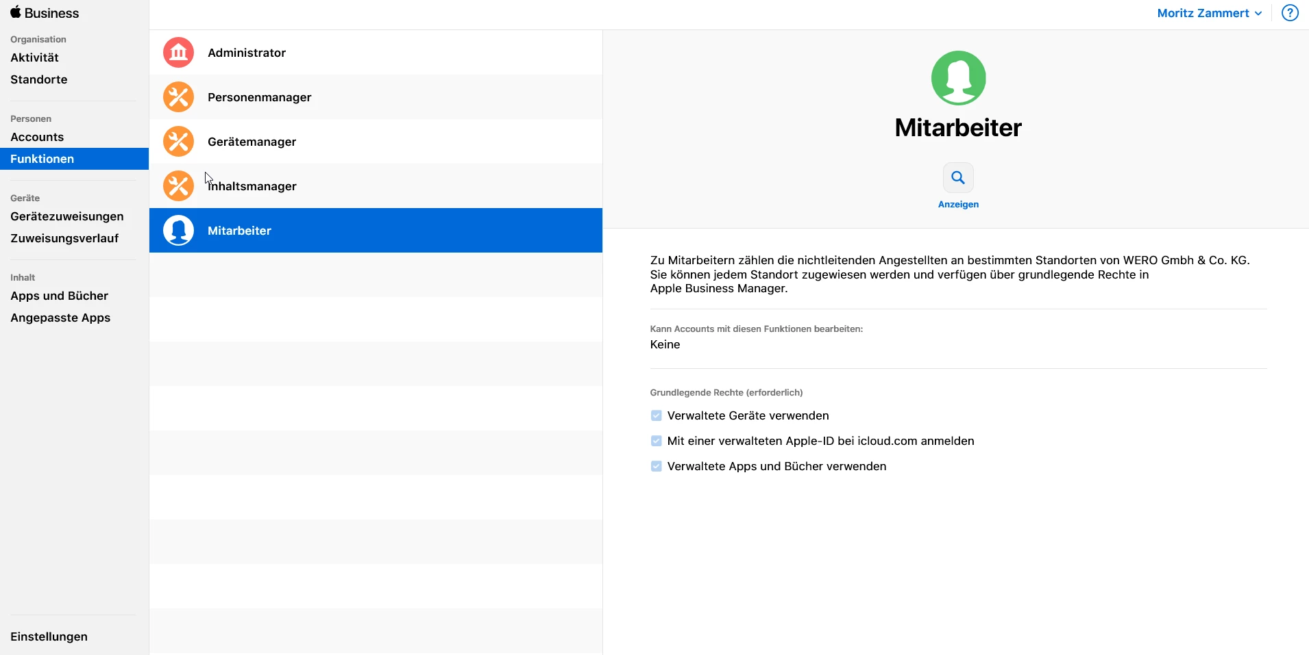

  • July 25, 2019
@seg_admin Sadly not :(
You can see it in the screenshot in my previous posts.

If I am using my managed Apple ID, FaceTime works. If I am using the managed Apple ID of one of our Staff Members, I get the errormessage you can see below.
Did you figure out what was the cause? I have the same same problem..2 of 10 ids are working, others get "Service not allowed" thingy...same settings and still..

Did skim through this thread so may have missed it but I don't think it got mentioned and this relates to ASM but might be available in ABM also?
Have you checked the Roles area? You can update the permissions on the roles for your environment.
  • October 30, 2019
Not up till now. Its still only in ASM not ABM.
In ABM only devicemanager got this rights and you have no way to change it.
