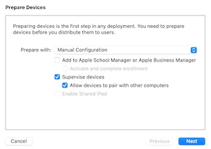

I released the device from ASM, couldn’t re-add through AC2 (Provisional Enrollment failed 33007 error message).
Then ended up manually supervising via AC2. The device is supervised and in Jamf.
Good enough for me until I replace them next year.
AC2 Prepare Device

I have been getting around this by unenrolling the device in Apple School Manager (ASM) then pushing a Wifi profile to the devices.  Supervising it like in your screenshot but making sure not to add it to an MDM.  After it is supervised then I push out an enrollment profile for Jamf School and then everything works.  After I re-enroll it to Jamf School in ASM to ensure others can’t steal it and find much use for it.
