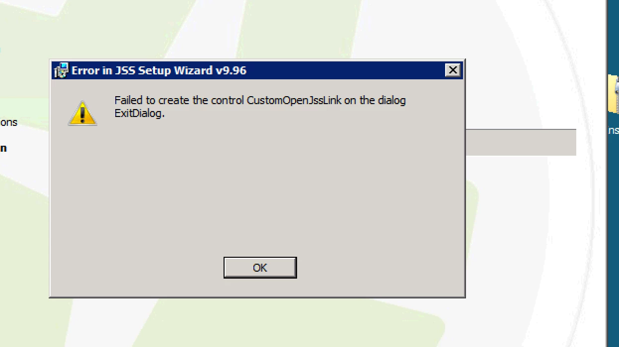

Hi All,

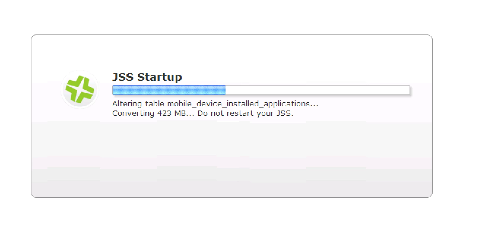

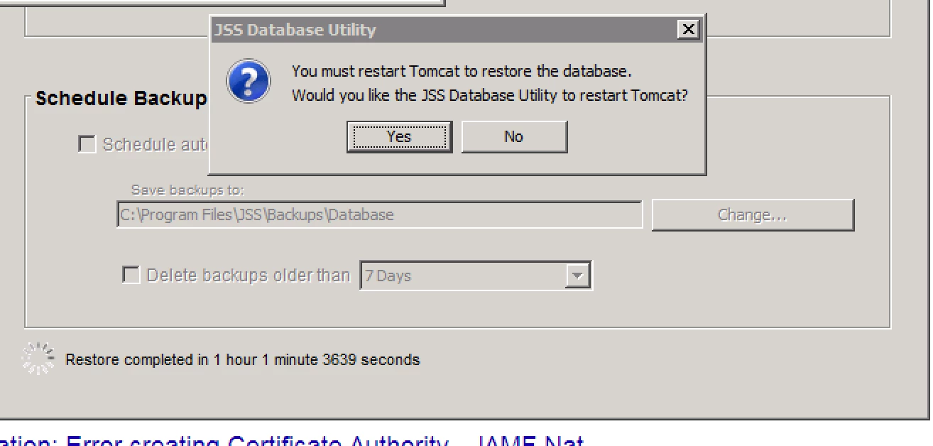

Just tried updating our Windows 2008 R2 SP2 JSS from 9.82 and got the first attached error right after it tried to start Tomcat.. I ran an a repair on the installer after it failed which completed the install and started Tomcat. The JSS got stuck at altering the mobile device applications installed table. I probably didn't give it enough time to fully alter it, about 30 mins (a later restore back to 9.82 took over 45 mins to alter it and that was just on restoring the backup).

The funny thing is that error happened when running the 9.82 installer as well. I ran a repair on that and I got the JSS to startup, but it displayed an error that I needed to upgrade from version 8 first. I had already dropped the database and recreated it and did the grant. Not sure why, but I dropped the database again, recreated it and restarted Tomcat without re-doing the grant again. Boom, it starts up and gets to the activation page. 1 hour later our JSS is back and working just as well prior to the upgrade.

Any thoughts from Window Server experts out therse?? I am tempted to try to update again, run the repair and let it finish the update, but I really don't want to press forward until I can keep from getting the "failed to create" error. Maybe the error is nothing more than failing to create the 127.0.0.1:8443 final dialogue box.... but still.
